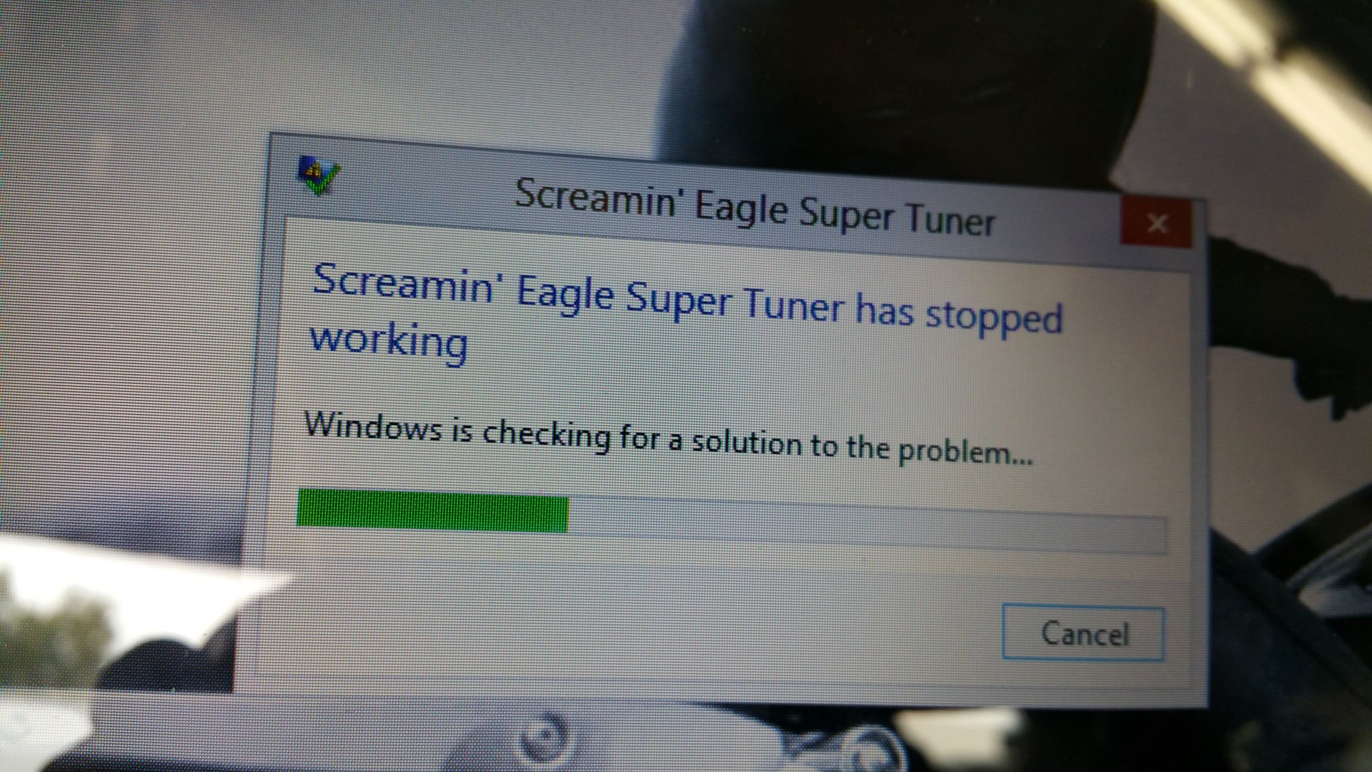

I think I am having problems cause I am using windows 8, it came on the computer. I am going to get a copy of windows 7 and start over.
I just have a ac and exhaust also.
