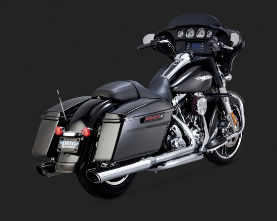

I've already purchased the FP3. My goal is to get the Twin Slash Rounds and the Dresser Duals. Might as well complete the package with the FP3.
