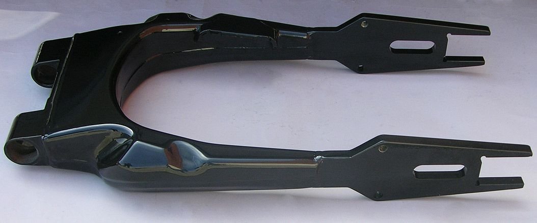

OK. You're convinced the Ohlins are set up right but want more suspension travel. Are you willing to convert from belt to chain final drive? If so, then JB Racing can set you up with an extended swingarm (up to 6") length so the axle travel can be increased. A thirty second Google search should get you there.
This is what I'm talking about. I don't think I'd want to go to chain drive, but now we are on the right train of thought. I was also wondering if there would be a way to make a swing arm with a bend / radius in it, that would move the shock mounting locations lower, but I think it would create clearance issues with the exhaust.
