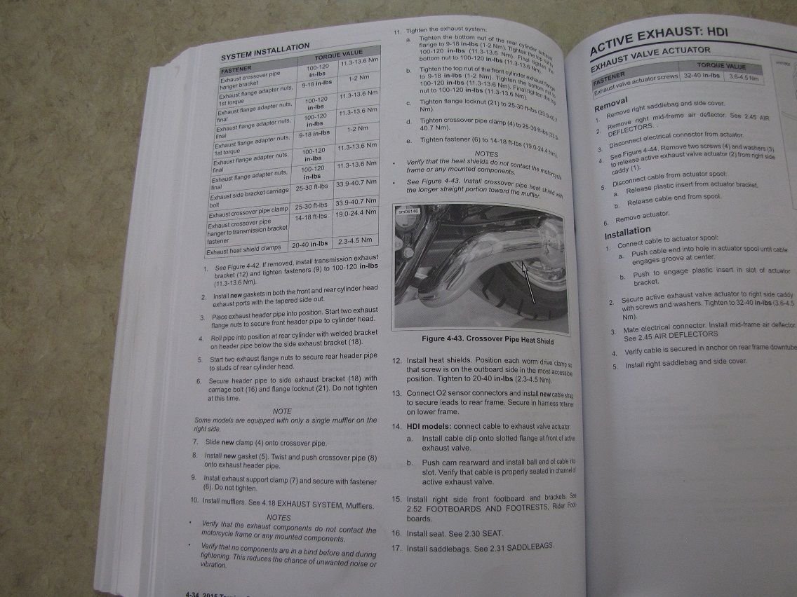

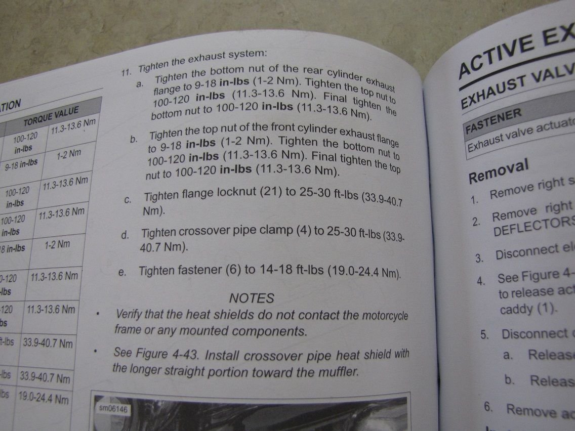

The V&H Power Duals use a flat gasket not the coned stock style. Look at the head end of the stock header pipe and the end of the V&H and you'll see why. Harley does have a Screamin Eagle exhaust gasket that is flat like the V&H if you want to have a spare on hand. I've put on several sets of Dresser Duals and a couple Power Duals using the V&H gaskets and never had a problem or leak. V&H has good instructions and I'll attach the tightening sequence from the HD manual.
This probably doesn't need to be mentioned but just in case: the exhaust flange torque is in INCH pounds. and you should check it again after a few rides
