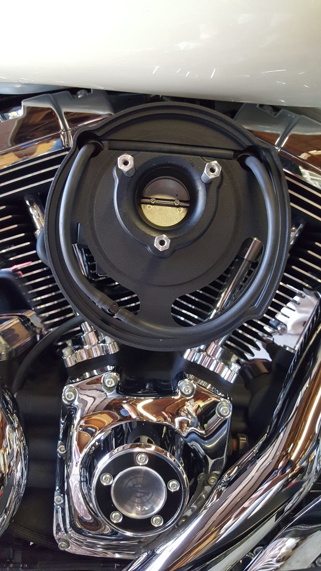

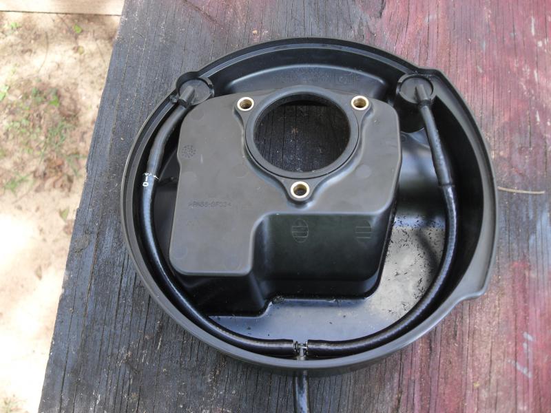

Here is how I did it...so many threads on this...
Attached Thumbnails External vent setup-air-filter-mod-1.jpg   External vent setup-air-filter-mod-2.jpg

Originally Posted by polbit
Do you guys see anything wrong with this set up? It's a Fuel Moto A/C, and some rubber hose with splitter. Routed it down with an open end close to crossover pipe.
The only thing I would change, is that I used a little black silicon to fill the void where the hoses used to run,to keep any dust from coming through the groove unfiltered into the intake. Also I put a little K&N filter where the hose ends just about bottom frame level. I may be a OCD, but that's my 2 cents.
