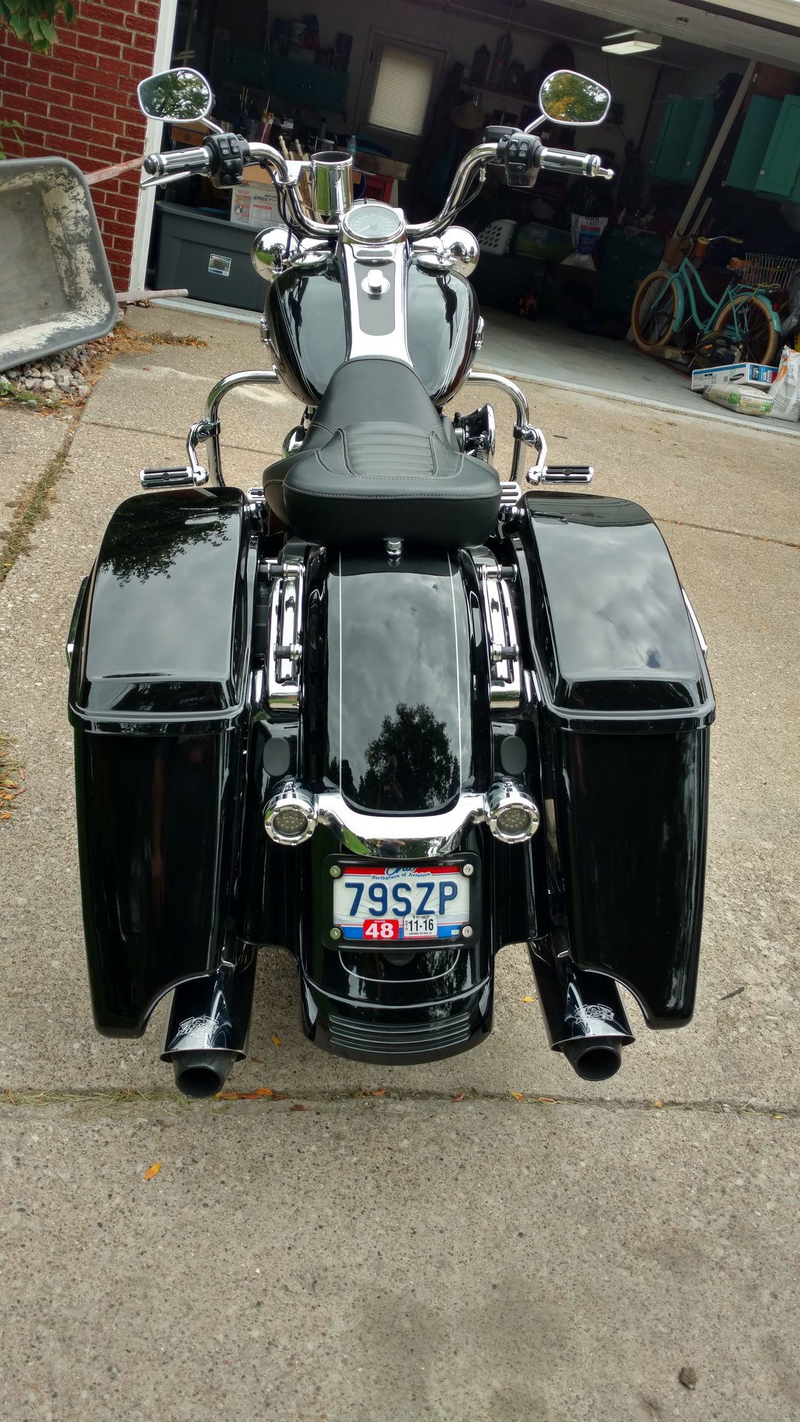

I know, I have been trying to find it and there is a break down but it is called a 'light"

I ended up using my original speedo and replaced the center disc with my ignition switch. Since I didn't want to cut the original wire hareness, I ordered the connector from the ignition switch to the bike harness (2 wire) and made my own jumper and plugged it in. As far as the speedo, I would have to order a new speedo that would marry to my BCM after 31 miles or 100 km so I just used mine. I really love the new dash, gives it a different look for sure.
