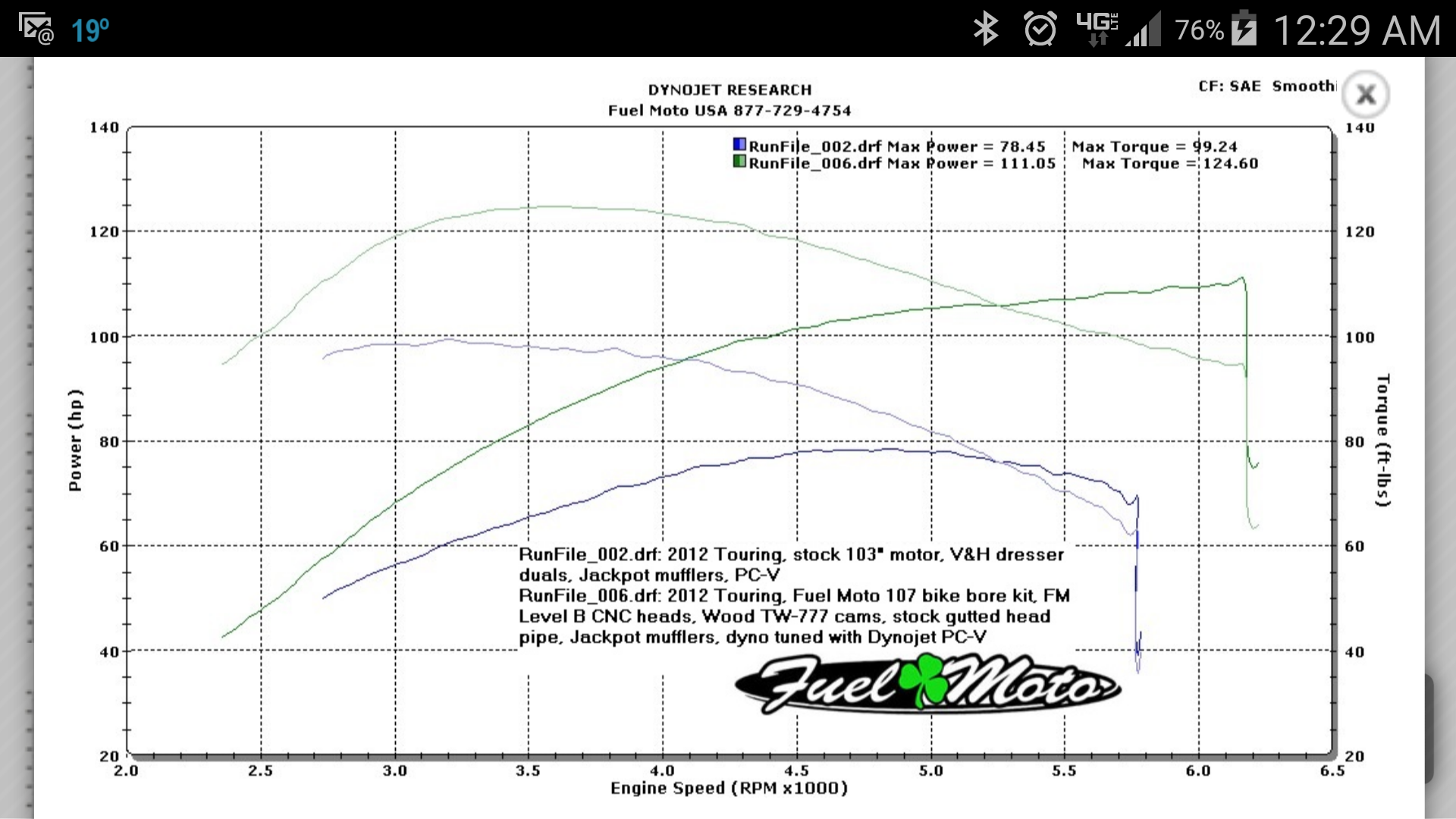

Here you go, just tuned from J&B Performance, 2012 Limited, decatted pipe, 255 cams in a 103, tuned with a Power Vision.

Without doing a dyno pull with a stock header, a decat and an "X" pipe at the same time the dyno sheet doesn't mean much. Nice numbers though.

The tuner is a good friend of mine and he said they compared dynos they have done and the decatted head pipe on a stage 1 or 2 build makes 10-12 more Tq. below 3200 rpm's than a X pipe does. I actually re-read the text to make sure I was telling you correct. This was with the 103's and 255 cams.
Now if you want to see some of the thing's your asking for, go to Fuel Motos web site or FB page and you will find it.

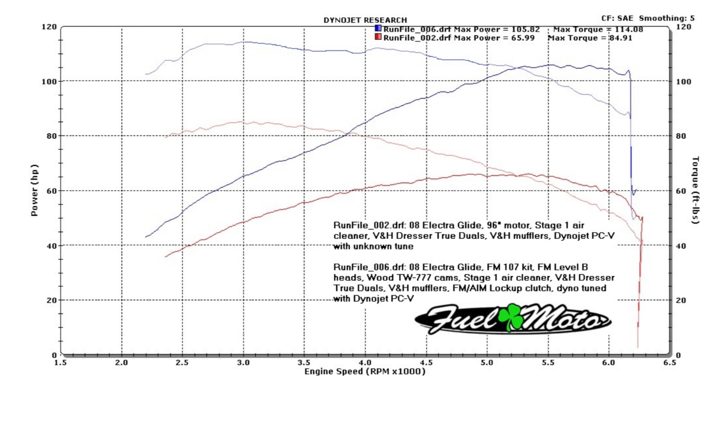

jt, I have posted this before but I can show the difference in a bolt in 57 cam and fuel moto's x pipe and rc 4" mufflers with 2.5" baffles compared to a Rush Wrath, same bike just a different pipe and retune.
Also from what I gather the stock decatted pipe is a little more restrictive than the x pipes which keeps a bit more back pressure, this is in theory mind you, I've never actually seen flow numbers to prove that but you can see in my chart the big difference in the bottom end than my 1st combo. Overall the x pipe made a little more Tq. but where the Tq. starts was night and day difference in the feel of the bike.

Different bikes different days but kind of the same.

I assume the rush combo is the red lines in the graph? 20ft lbs at 2500 is huge.
Yes Sir it is but the key is in the combo of the exhaust as well. Jamie and I had a discussion back in the dyno section about this when I posted that sheet. Look at it like this, If 1 2.5" baffled muffler will carry that much Tq and Hp down low then the question is how, back pressure and flow, thats also why the wrath is a stepped design as well. Now take that same amount of flow from say a x pipe design and install mufflers with 2.5" or bigger baffles and what happens, no back pressure, bottom end suffers. The top end Hp. may pick up or even a few numbers higher on Tq. but where you ride most of the time will not.
