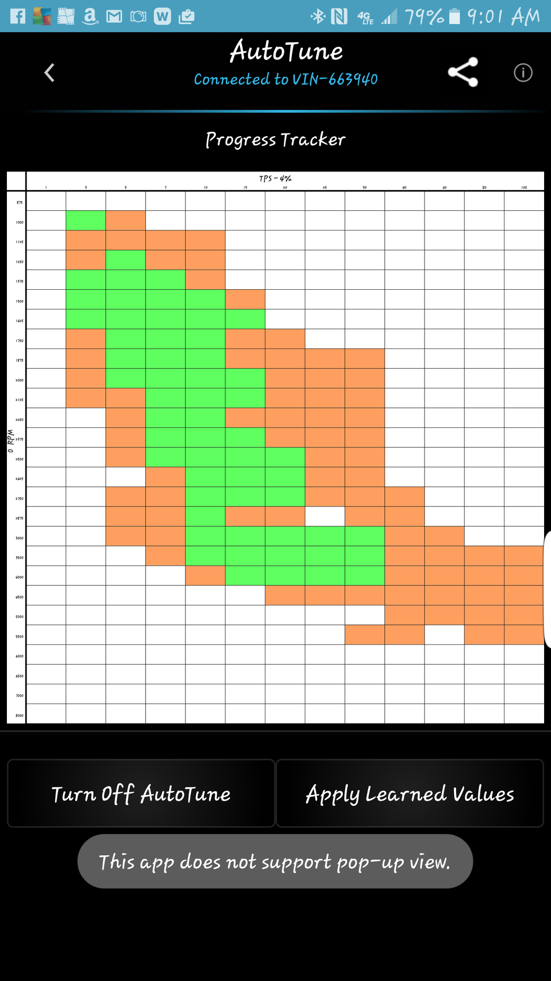

First auto tune run this morning. Seemed a perfect time. Sunday early. And I'm out in farmland but close to the interstate. Was able to hit some good WOT runs. 4th gear @ 6000rpm is 105 mph BTW. 3rd is 85ish.
This was my first ride with the new base map and like others stated. It will sputter at first. It did. After the first 500' it acted right. I tried different things. 45mph 2nd for a mile. 3rd for a mile. 4th for a mile and so on. Picked up a lot of cells. I loaded the new map and will keep the auto tune on for a while.
