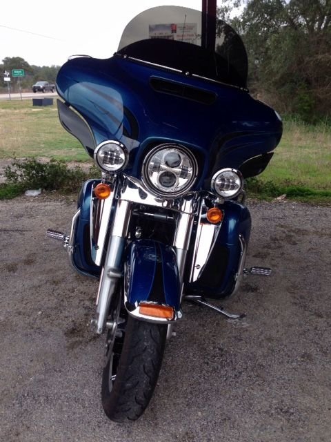

You can mod the HD fangs just a tad and you can put them on a TK. I have. I only use them in the winter though. Too hot in TX to use them in the summer.
Pic is when I was running a 10" Freedom Shield. Ended up switching to an 8" You can also see the fangs.
With 8" Freedom Shield:
