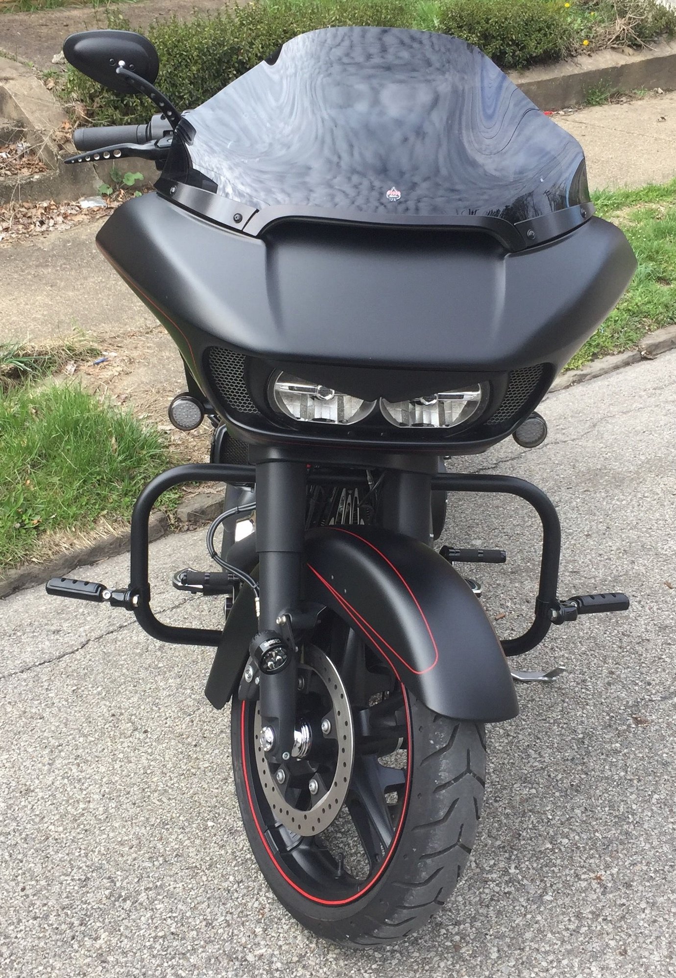

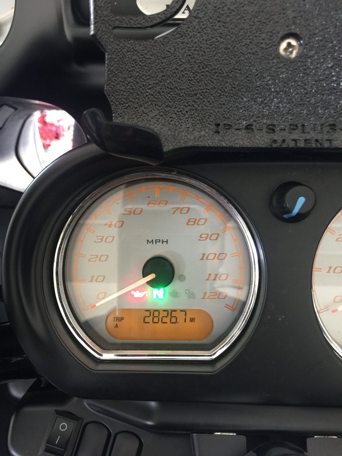

​​​​​​My Clearwater Darla setup on Road Glide. Front fender mount setup with dimmer switch mounted in between speedo and tach

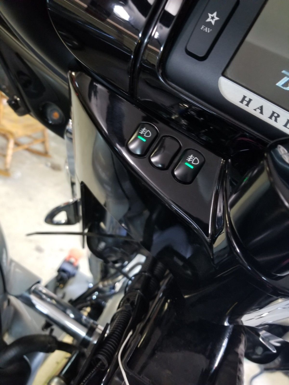

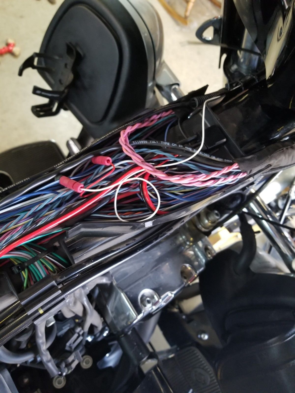

Got my Darla's installed this afternoon. Pretty easy job, just had to recheck the posi-taps with four wires a couple times. I just followed 2015UltraLimited's method. All I need was the accessory light switch. You do not need an additional wire harness if you have an Ultra. Just plug the switch in the panel, posi-tap the wire for it, and posi-tap to the high beam wire. Thanx to the OP and to 2015UltraLimited for the guidance.
