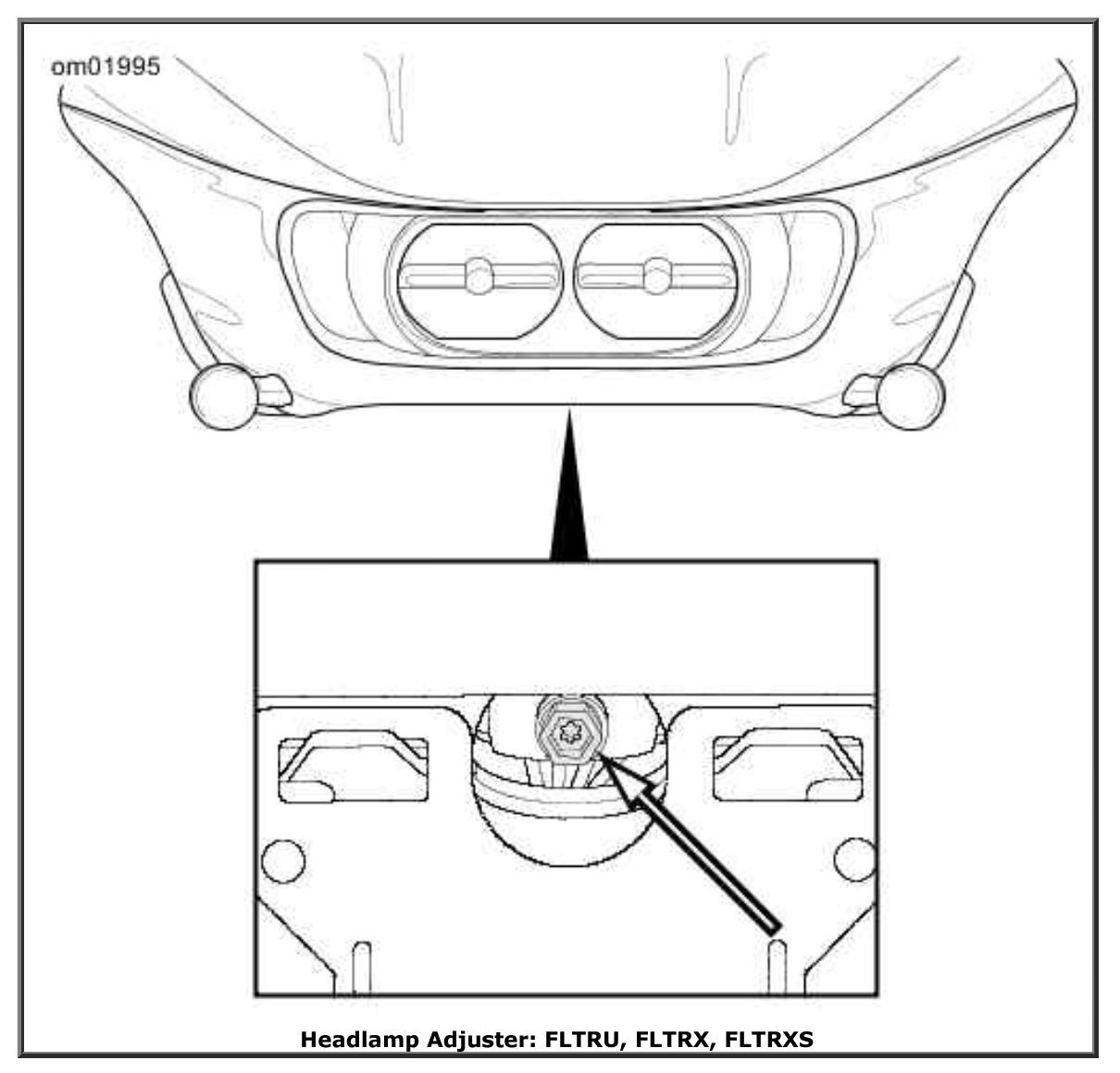

Here’s the pic from the owner’s manual showing the location of the adjuster. You can use a 9mm socket, a 6mm Allen or a T15 Torx. (Vertical adjustment only on the RG)
It will take a lot of turns to see the change. It is a very fine adjustment.
Wow! I can see! I think I'm in love with my bike again.
One of the reasons I bought an HD was because I loved the daymaker headlights on my wife's trike. But for the last 2 years I've been riding my RGU thinking it was just as poorly lit as my old Yamaha.
However, 10 minutes with a 9mm ratchet and a little help from my wife, and it's every bit as bright as her Tri Glide. When we started, at 25 feet, the center of the high beam's bright spot was almost to the ground.
