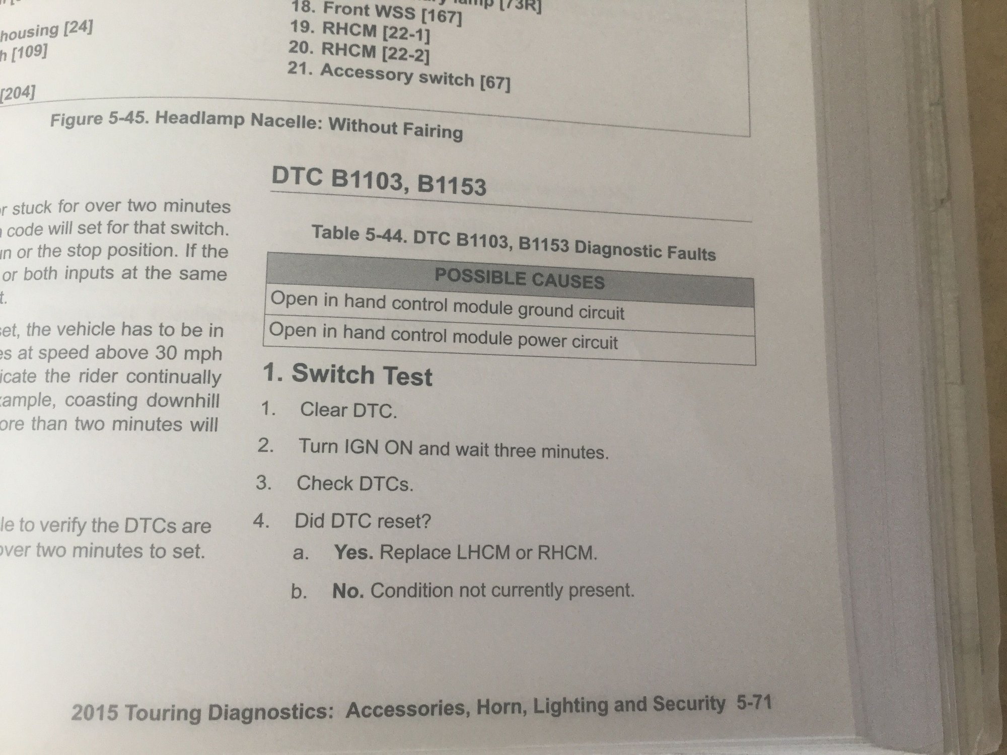

Just checked the codes. Found a B1103 code which, when looking up on Google, shows as a LHCM Internal error. Guess I need to replace my lighted switches.
