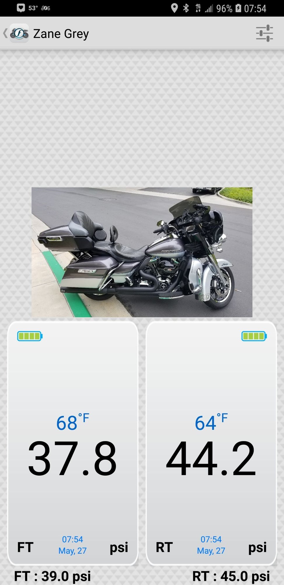

I use FoBO TPMS, just make sure you use metal valve stems.
https://my-fobo.com/Product/FOBOBike
The pic is my app with the OAT at 60 degrees. I have it set up at 39/45 cold max. However, at 3:00 today the OAT will be 82 degrees. Without touching anything my tire pressure by then will be in the ballpark of 41/47 cold pressure. I am really **** about tire pressure, obviously. So, the best time to set max cold pressure is when the OAT is at its highest. Then once you're running as the tire heats up the pressure increases. So the two factors that account for tire air pressure change are the OAT, and the heat of the tire itself. Even on my truck that sits outside in the sun. If I go out at 11 am, the right side tires have been in the sun all day. They will be 3 lbs higher then the left, which have been in the shade.
