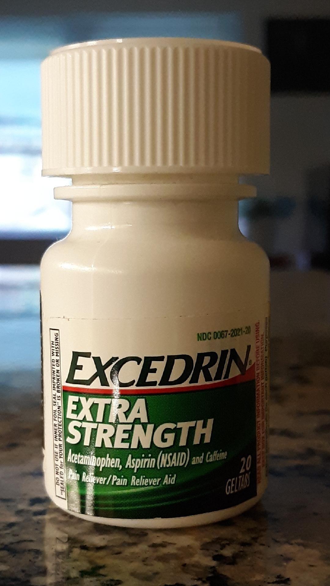

Finally did the breather bypass on my 16 Ultra after 10000 miles. Used a small Excedrin bottle for the can. Went for a 25 mile hard blast up the highway and back to induce puking, but the bottle was bone dry afterwards. How often are you guys emptying your bottles err I mean cans?

Empty mine around 500 to 700 miles; not much in there even then.

I can't tell from the photos, but did you vent your catch bottle can? FWIW, I didn't use a catch can.

Look below the air filter...he painted it black, I didn't see it at first.

Ok I am glad to hear not much gunk comes out too fast. I was expecting more. I did drill 6 really small holes in cap so it does vent well. Thank you for the replies.
