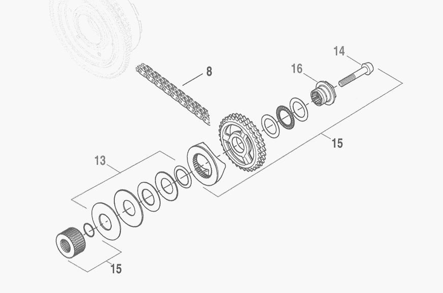

Here is what it says in the parts description for the Screamin' Eagle Big Twin Compensator.
Original Equipment on '14-'17 DynaŽ, SoftailŽ and '14-'16 Touring models. Requires separate purchase of Installation Adhesive Kit P/N 11100088.
The M8s are the same except for a the parts breakdown for their compensator assembly shows a single thrust washer in place of three washers before the sprocket retainer.
