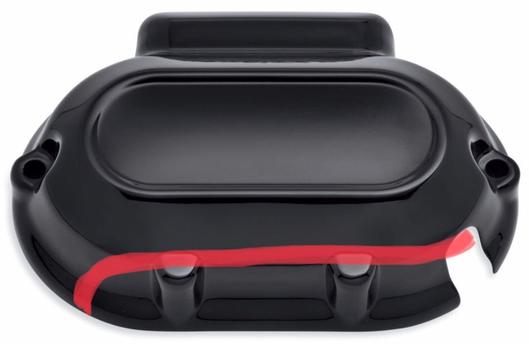

K Melancon's Avatar
K Melancon
Joined: Mar 2011
Posts: 1,456
Likes: 132
From: Deep South, Louisiana
Was talking about the exhaust being in the way on another post. This is my plan next time the clutch is flushed. I will cut the bottom of the cover where it curves under so that all I have to do is remove the cover screws and lift the cover straight up. It is not sealed since it already has a hole for the hydraulic line to pass through.
