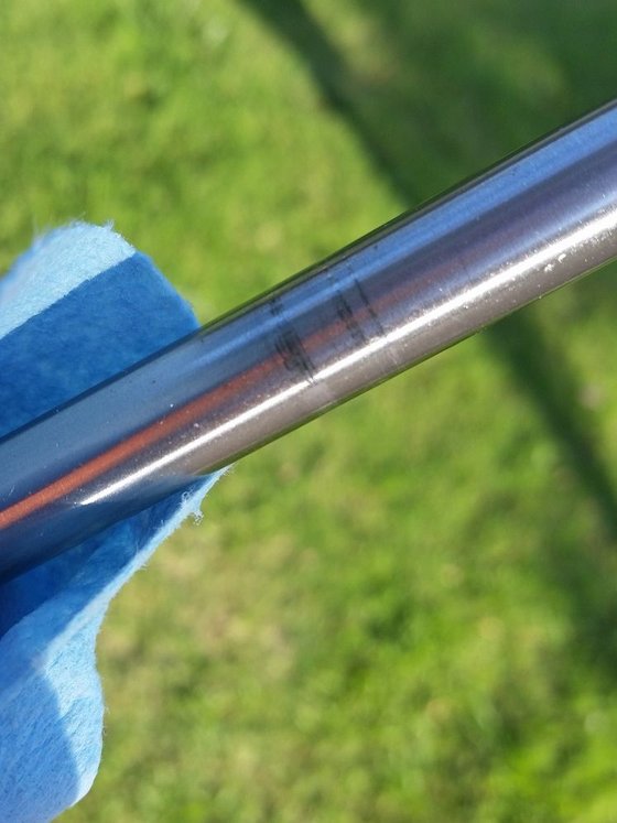

Maybe the pushrod is contacting the tube at the top.

I have the same setup - been chasing the same noise from front - i am starting to think it is the lifters - i have gone to 3 full turns instead of the 2.5 as per harley on there pushrods and no diff -
S&S lifters are next

I am using Spectro 25w60, which did reduce the noise a bit. Have about 3000 on the current oil - the louder, clatter version of the noise started about 200 miles ago.
I readjusted the pushrods to, if I do remember correctly, the same 3 turns 3 flats on SE pushrods = .140.
Re-torqued the header bolts. A little give at 115 inch pounds, but probably within spec. Put rags over the exhaust and did not hear an increase in ticking.
Not sure about the lifter bore comment.
I have not ridden yet, but have started up a couple times and that initial start up clatter is no longer present. Still more noise than I would prefer, but seemingly back to the original noise. I have at least isolated to the right front cylinder area.
