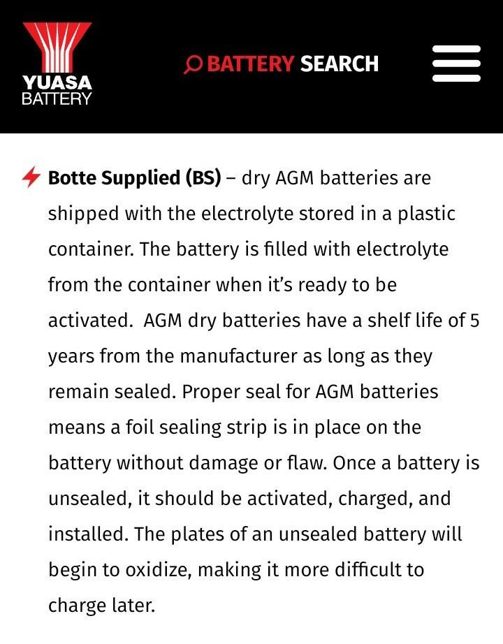

According to Yuasa, a dry battery has a shelf life of 5 years from the date of manufacture.
