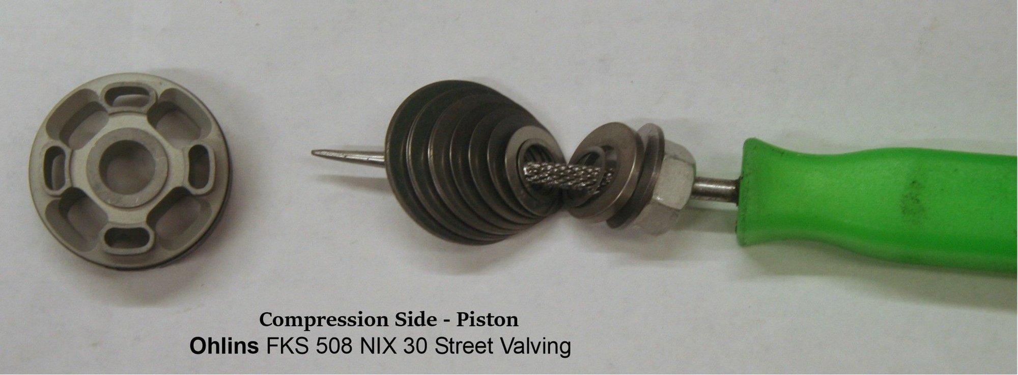

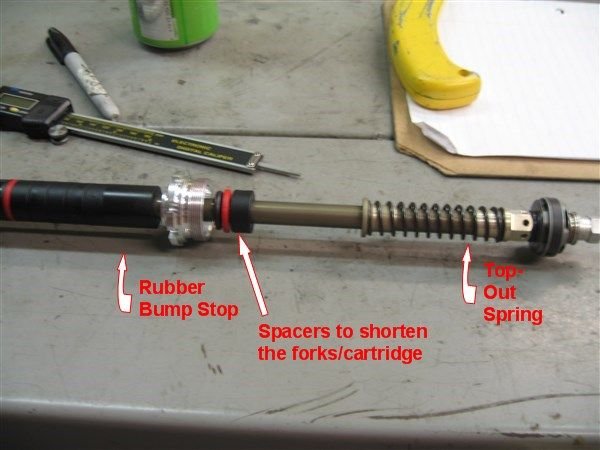

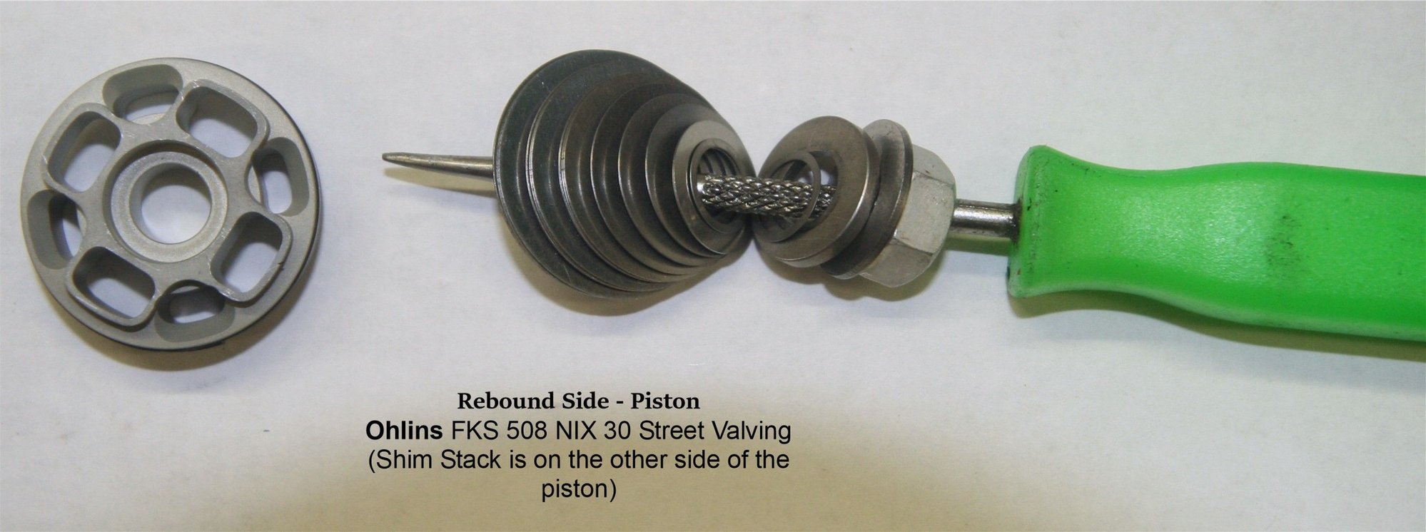

Made coffee, watched the local news, read fake media (Yahoo) "news", read several forums, and finishing up here. The street valving (without enclosed top out spring) is an inexpensive way to make a cartridge. It does compression & rebound by using the two sets of shims. In order to actually control your front wheel is to use your rebound shim stack and long top out spring . When you use a check valve as a perch and the very strong OEM top out spring, no extra control is used because you are relying on the maximum amount of stroke available (around 4 1/5" max). When you remove the check valve and use the new top out spring to limit your increased stroke, valve the cartridge and use a longer yet 3 N/mm or so top out spring so the wheel can travel controllable down into the hole. With no hole your sag sets the front end length and the bike will ride around that point, sag to bottom out. Extraordinary events are handled by the extended week top out spring. Of course the suspension must be built with this in mind from the beginning.
No top out spring and less exotic piston holder and needle valving passageways.
Compression side of 30mm piston Street
rebound side of 30mm piston Street

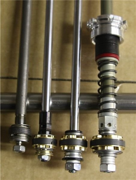

Much bigger oil ports & expensive coated 30mm Road & Track piston
30mm Road & Track Cartridge.
Piston Size Compairson Left to Right *20mm Premium HD Cartridge * 20mm Ohlins replacement * 25mm non-adjustable Ohlins * 30mm R&T Ohlins
