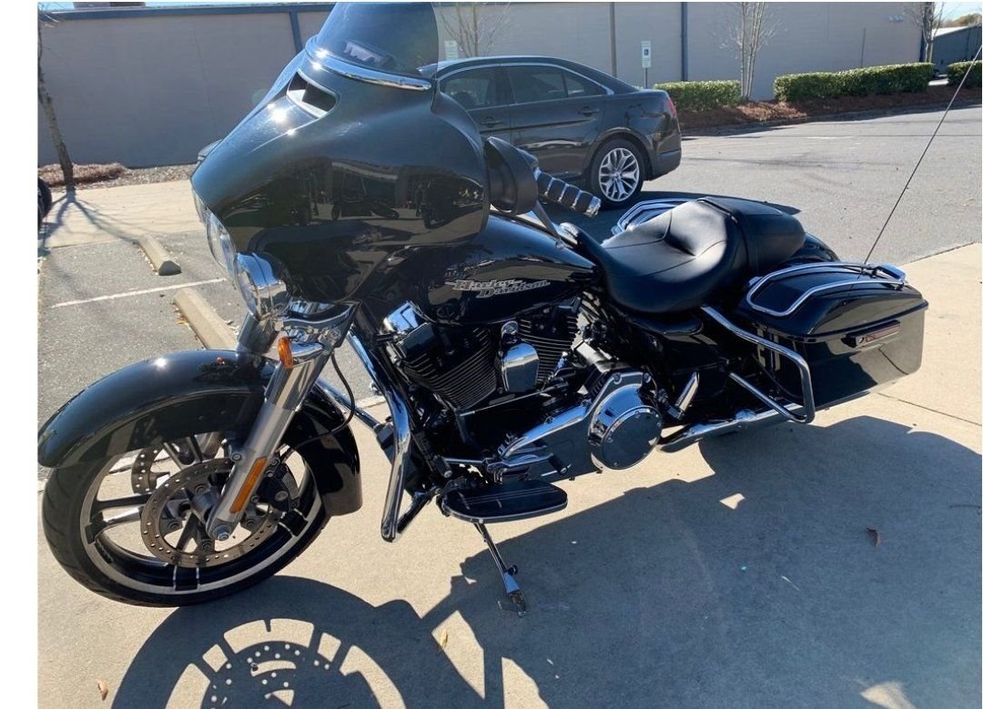

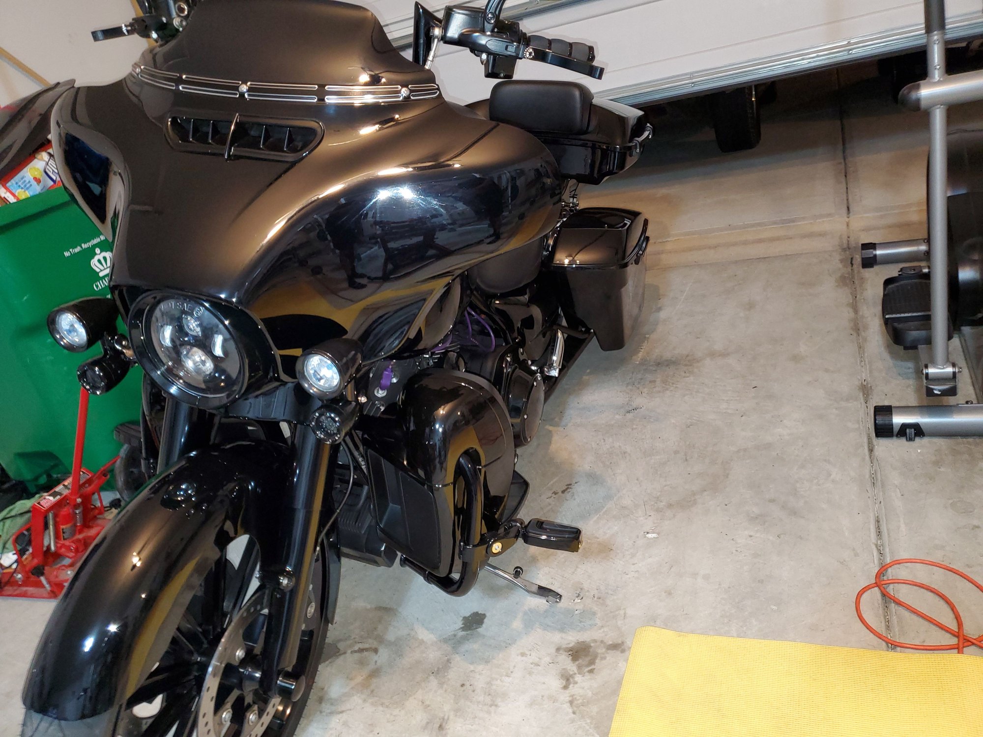

It's possible. I bought it used but it definitely has an aux button. Here is a before and after.

I like the after a lot. Nice looking bike.

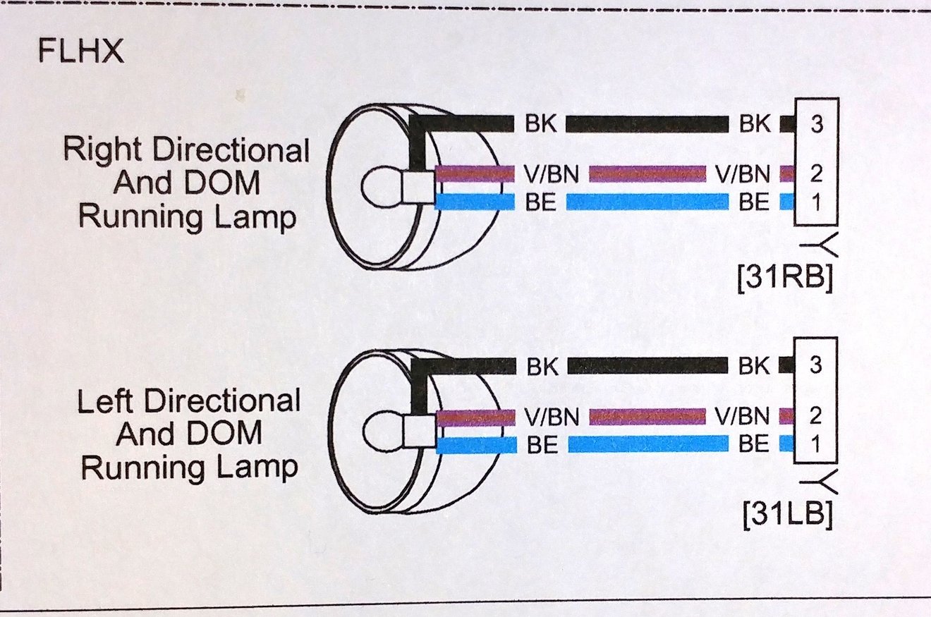

Yea, looks like PO added lights. Here's some wiring diagram shots from 2014 Service Manual. Maybe this will help sort this out? I think the first check would be to confirm the AUX (fog) lights are connected to pin 4 of the mating connectors? Good luck!
