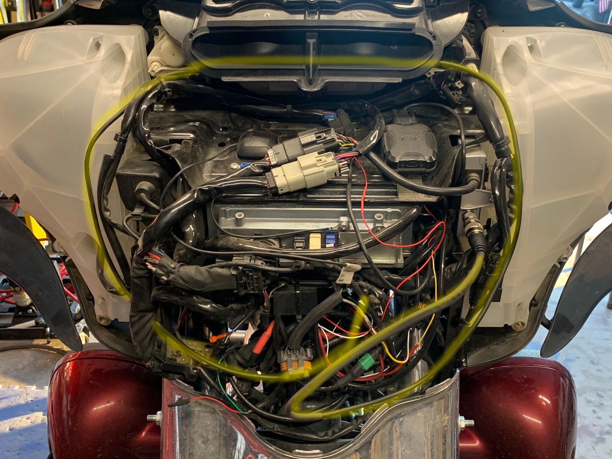

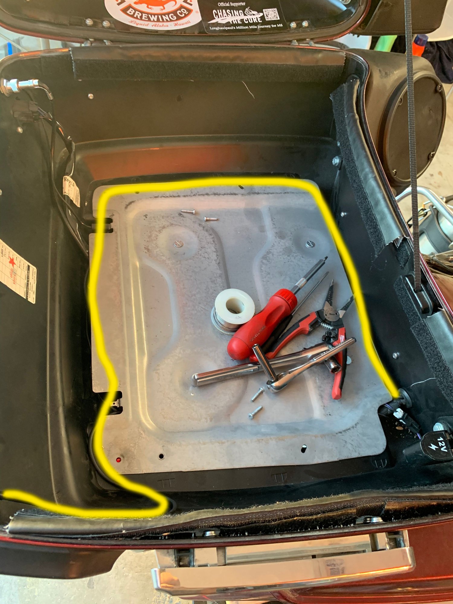

So far so good. I got the Firestik NGP Antenna System on the bike now. I buttoned everything up Friday night in the garage before an early Saturday morning ride. So I did my tuning in the worst possible place... inside my shop.
I did a quick test in Death Valley on a group ride the next morning (hence the rush to get everything buttoned up Friday night) and I was getting one mile easy (was the furthest I tested it). Even with the questionable tune, we could hear each other clearly. I'm thinking 1.5 miles is perfectly doable with the current tune and >2 miles with a better tune on it.
17' of coax was no problem at all. I came off the back of the CB Module, then routed basically a big lazy loop inside the front fairing beforeI brought the cable down the left side of the frame neck, under the tank. I kept the coax on the left side of the bike under the seat then just followed the cables up along the other cables that go to the tour pack. Once inside the tour pack, I just ran it around the edge of the metal plate back to the antenna mount.
I had to use two adapters:
1) Antenna adapter to use the stock antenna mount with the Firestik.
2) Adapter on the coax cable to screw into the CB Module.
The coax is wrapped with tesa tape inside the front fairing and inside the tour pack to keep possible rattles down.
(pictures were taken during test fitting, tape wasn't wrapped yet)
