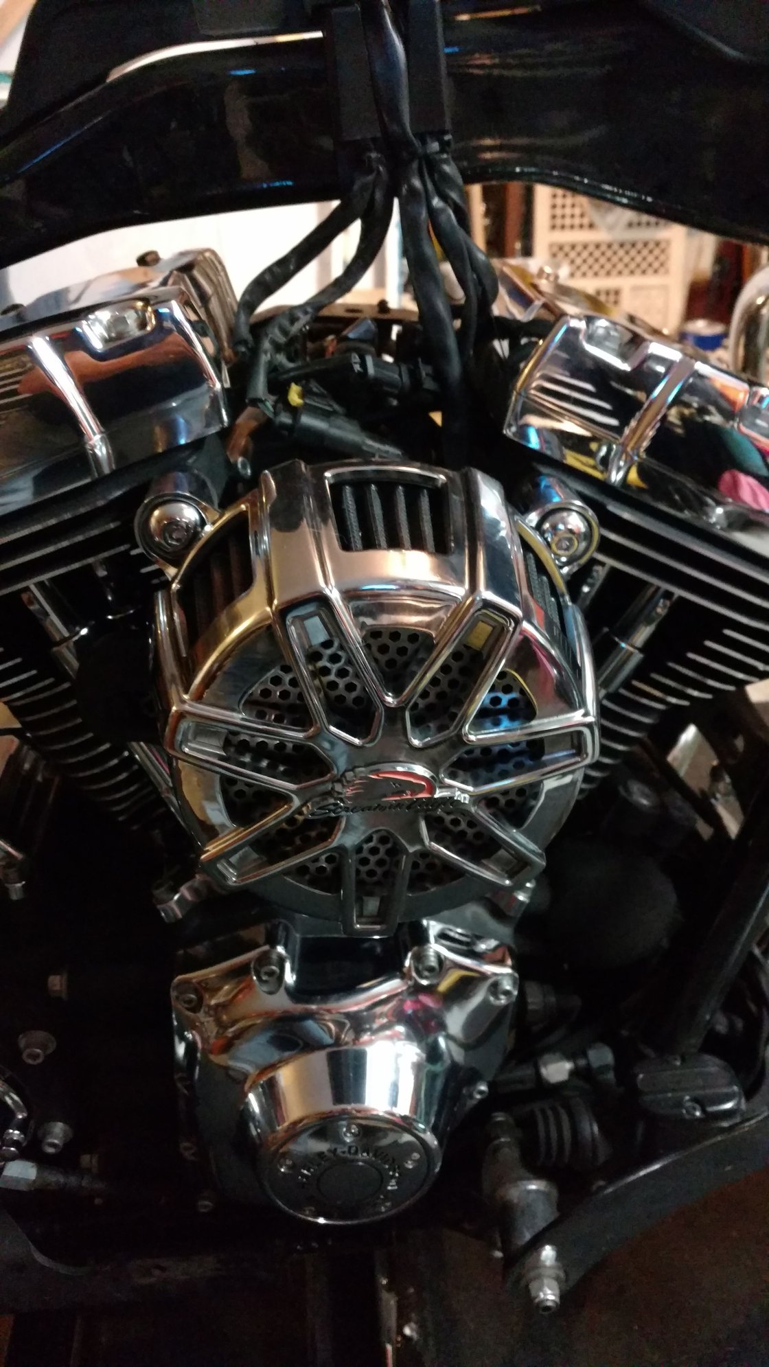

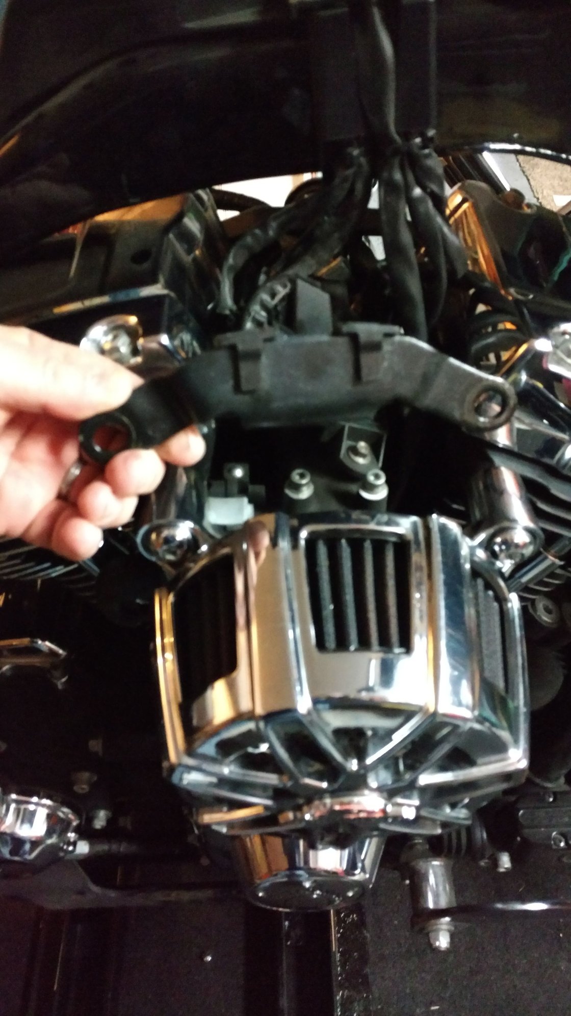

I have a Thundermax autotune. I will download a map and go from there. Last night I installed the intake, I hadn't had too many beers but could not figure out why my air cleaner no longer fit. it had a gap between the intake and back of the Screaming eagle aircleaner. It was the exact distance of the brace in the photo. I took it off and the air cleaner bolted up perfect. i have no clue why except that the bosses of the Screamin Eagle CNC ported heads have an extended boss. Anyone have any input?

I called Fuel Moto, and they have seen this before on different heads. The proper repair is to leave that brace out

most performance breathers require to leave the brace out !
