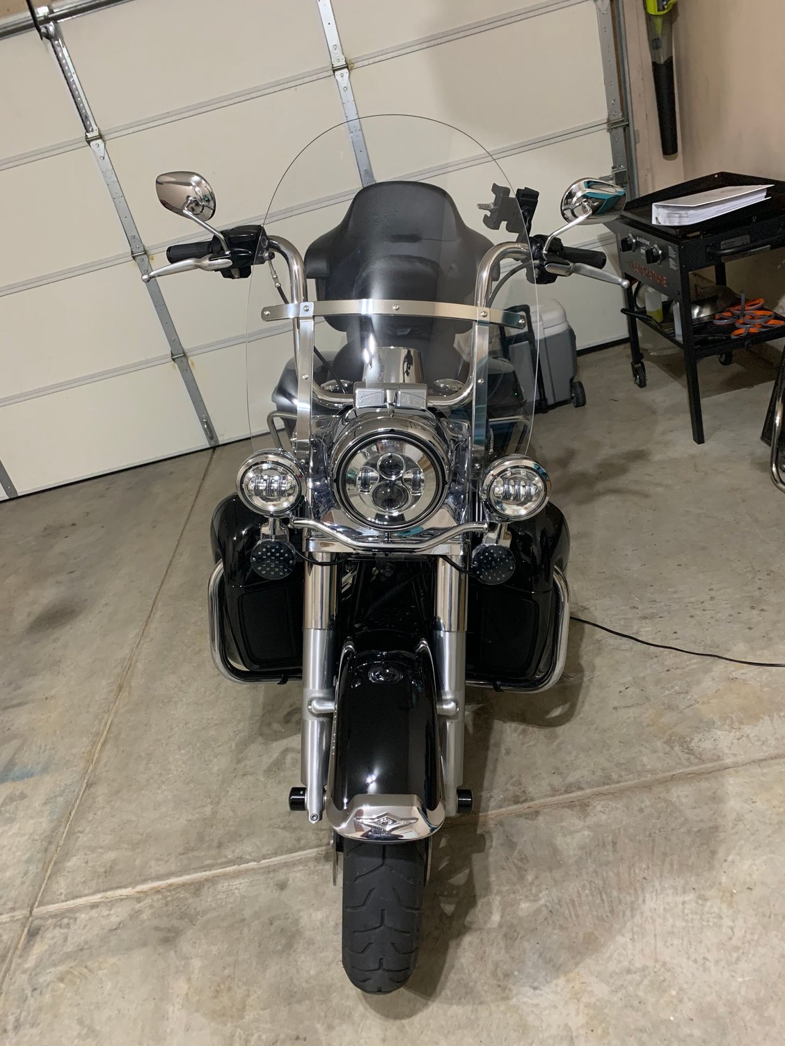

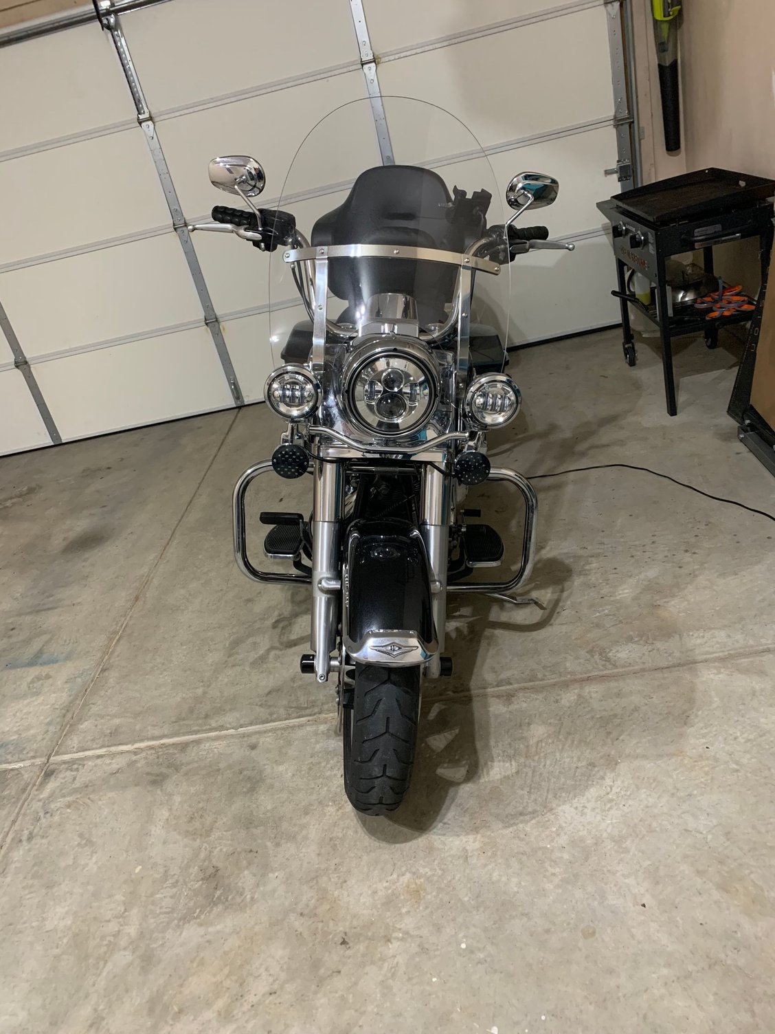

Got the bars on today! I must say for my first handle bar job, I’m impressed with myself! I definitely agree there’s way more “fear” in this being a difficult job that there should be. At least as far as bar jobs that only require wiring extensions.
Internal wiring went easier that expected for the most part. I used a string to pull the wires through the bars vs using a small chain, like from a ceiling fan, that a lot of YouTube videos suggested. I would DEFINITELY recommend trying the train vs the string, and regret not picking one up before I did this job. I followed the internal bar wiring video on KST’s YouTube for tips. Cutting the thick black loom type of stuff off the TBW sensor wires is a must. I tried pulling them with it on just for a peace of mind and it was impossible. Other than that very straight forward.
One last thing is I would recommend changing the riser bushings while doing the bars. Definitely the time and place for it. I upgraded to HD poly bushings and am impressed with the quality.
Totally happy with the outcome and can’t wait to ride it.
Before, stock bars that I believe had been rolled up
