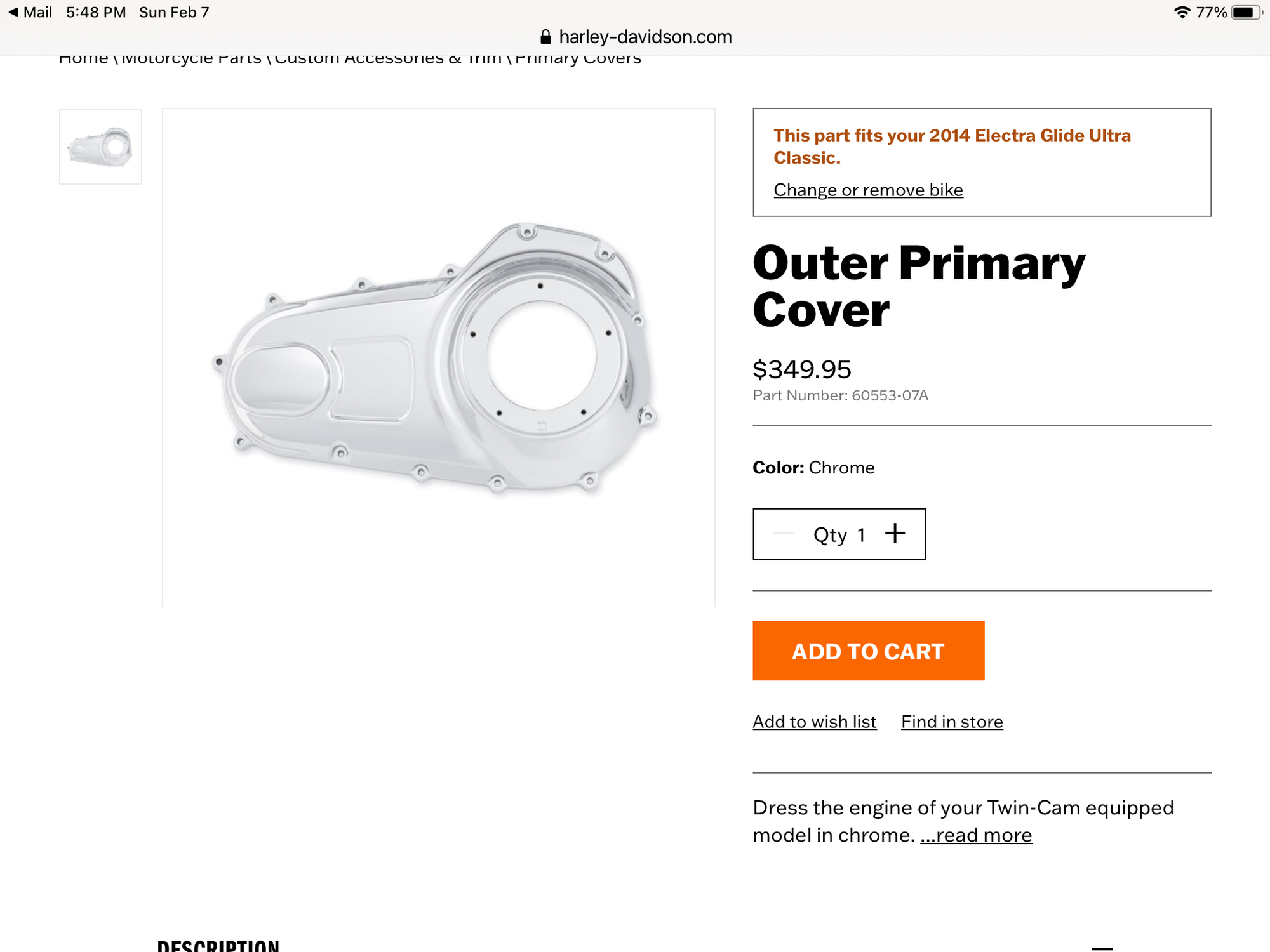

That stamped was on a primary cover listed on ebay. Says it came of a SGS, I forget the year, but it was within the range.
Hammz
Thats interesting, since the HD web site clearly says it will fit my 2014.
Here's a screen shot from their site

  1. The web shows it fits because it's NOT a narrow primary cover & in fact, was oem for 2014 FLHTK.
  2. The mod to sling oil on the compensator is part of the SE compensator kit & may or may not be installed in the primary cover, depending upon which compensator was installed on the take off bike. In this case, it appears not to be installed.
