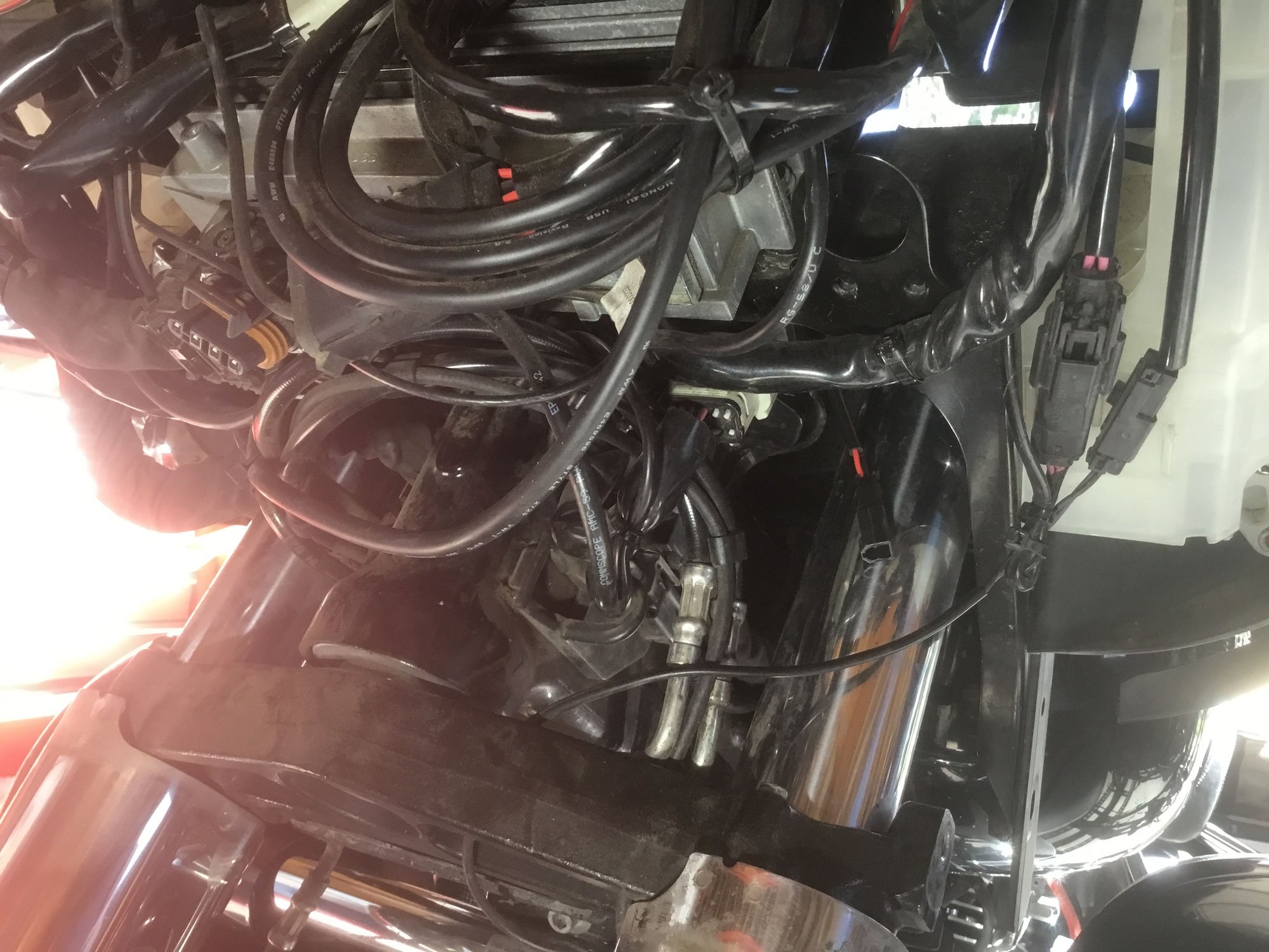

Default Please help
Ok so the fairing removal went smooth, HOWEVER I have spent well over an hour looking for the power wire. The HD instructions are pretty much useless. Every video I have watched shows it somewhere near the left fork tube, but I have looked and looked. Every connector there is connected to SOMETHING. Here is a pic of the left side. I did find the right side wire, was up near the handlebars..
The red and black wire on the fork tube is the wire from the left side grip
