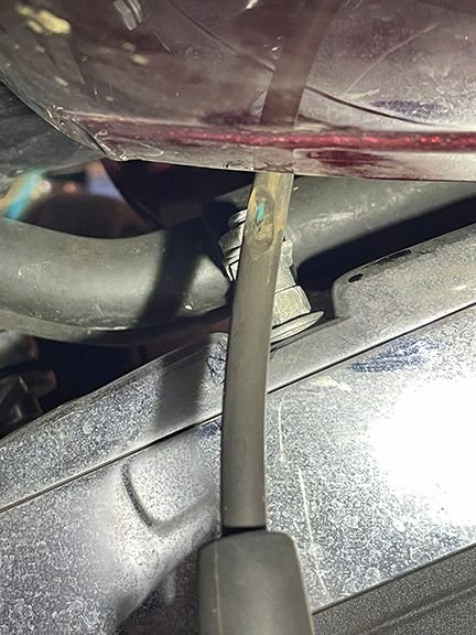

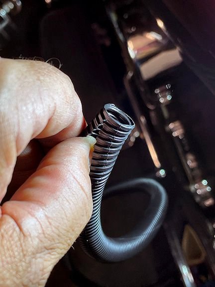

Originally Posted by pswomack
I would definitely look at the ….spark plugs/wires…..
Yes. Left side where they rub against the gas tank.
(I learned that here after someone posted it.)
My fix was tape and some plastic wire tubing.
I remember reading about this years ago, I regularly check the wire for wear. I can feel a very small indent but it hasn't gotten any worse, I'll keep watching it, thanks!
