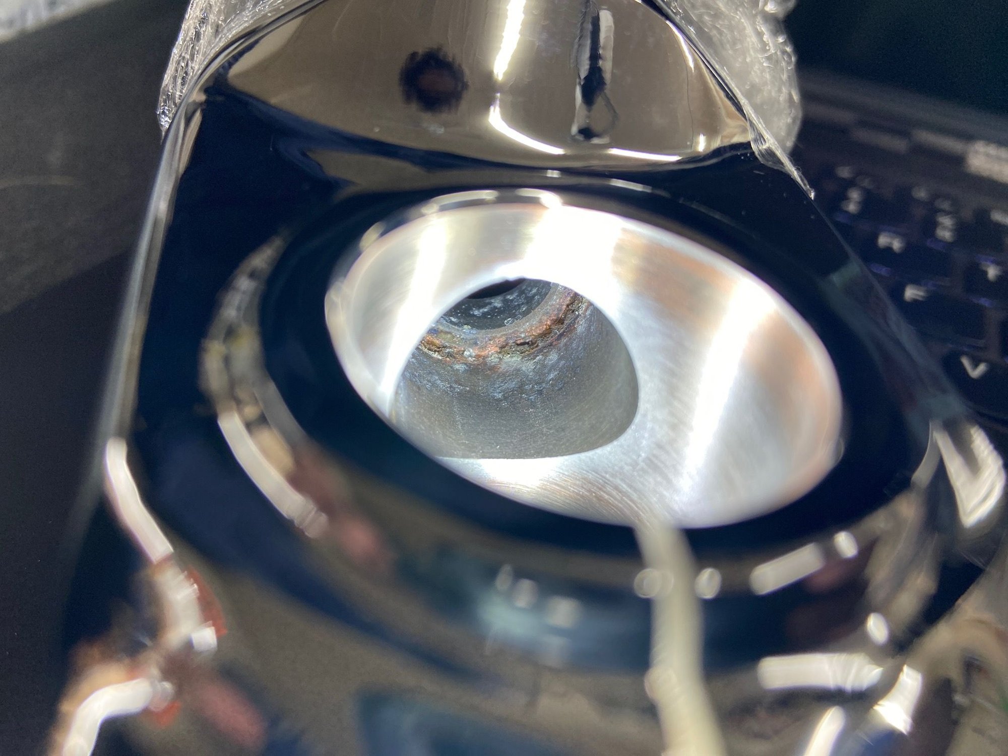

I bought chrome fork lowers from ***** Shiny that came in yesterday. The surface that the copper sealing washer goes on has a lot of hard corrosion or something on it. That area is hard to get to to clean it out.
Any ideas on how to clean this out? For the people who will say "ask the seller", I would, but two other questions to the company have gone unanswered.

Is that crud or rust? It looks like rust. If it were me, I'd return them. I have no real solution to cleaning it up, but a washer will never seal on that surface. Did they send you used parts? Or perhaps those parts were sitting out somewhere for a really long time.

Call the company first and see what they say! As soon as you take it upon yourself to try and fix it they are yours. And you will have no recourse to refund or return.

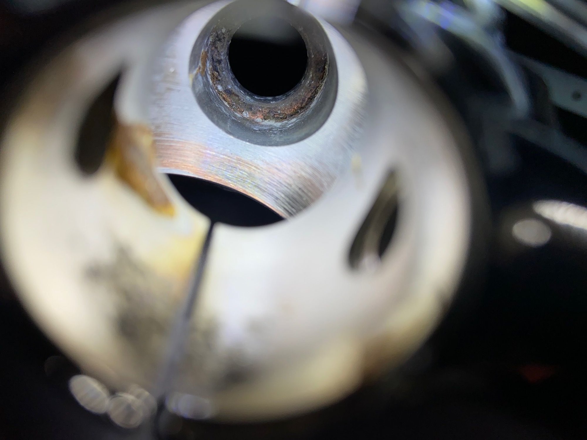

I called the shop and the gentleman asked me if i could just scrape this stuff out. I sent him a pic so we'll see what he thinks.
I will say, the offer was made immediately to replace these with another set, which means a lot. I would like to avoid another 2 weeks downtime if possible though.
Another pic

Then, maybe try some emery cloth on the end of a drift punch or even on a dulled flat blade screwdriver.
The problem is that even if you clean it up and it still leaks, you have to get a whole new fork seal kit and do all the work a second time. How does the other leg look?

The other one looks OK. It looks like someone forgot to clean this one up before sending it off to chrome. I never got a reply from ***** Shiny. Funny enough, their website showed that the legs come with chrome caps for the other bolts that I didn't get either, I asked about that and they said the place they were getting them doesn't sell them any more - Take them off the website or find a different suppier then. Come on.
I guess I'll be sending these back since they never called me back. The bad leg has junk under the chrome in spots that will make it peel before long. Not a good $300 experience.

I'd run a gun bore brush in there on a drill and give it a buzz, if you don't have any, hit your local Walmart. You could even go with a pipe fitting brush from Lowes or Home Depot.

As I don't want to wait 3 or 4 more weeks for this process, I sent my core legs back and I'm using the ones they sent. I was able to clean the corrosion off, hopefully the copper washer will seal. As for the chrome not adhering properly, it's in the same area as the bolt and copper washer go, so as long as it doesn't peel more, it'll be OK. If it does peel, ***** Shiny has a 2 year warranty on them so I'll deal with that then.
