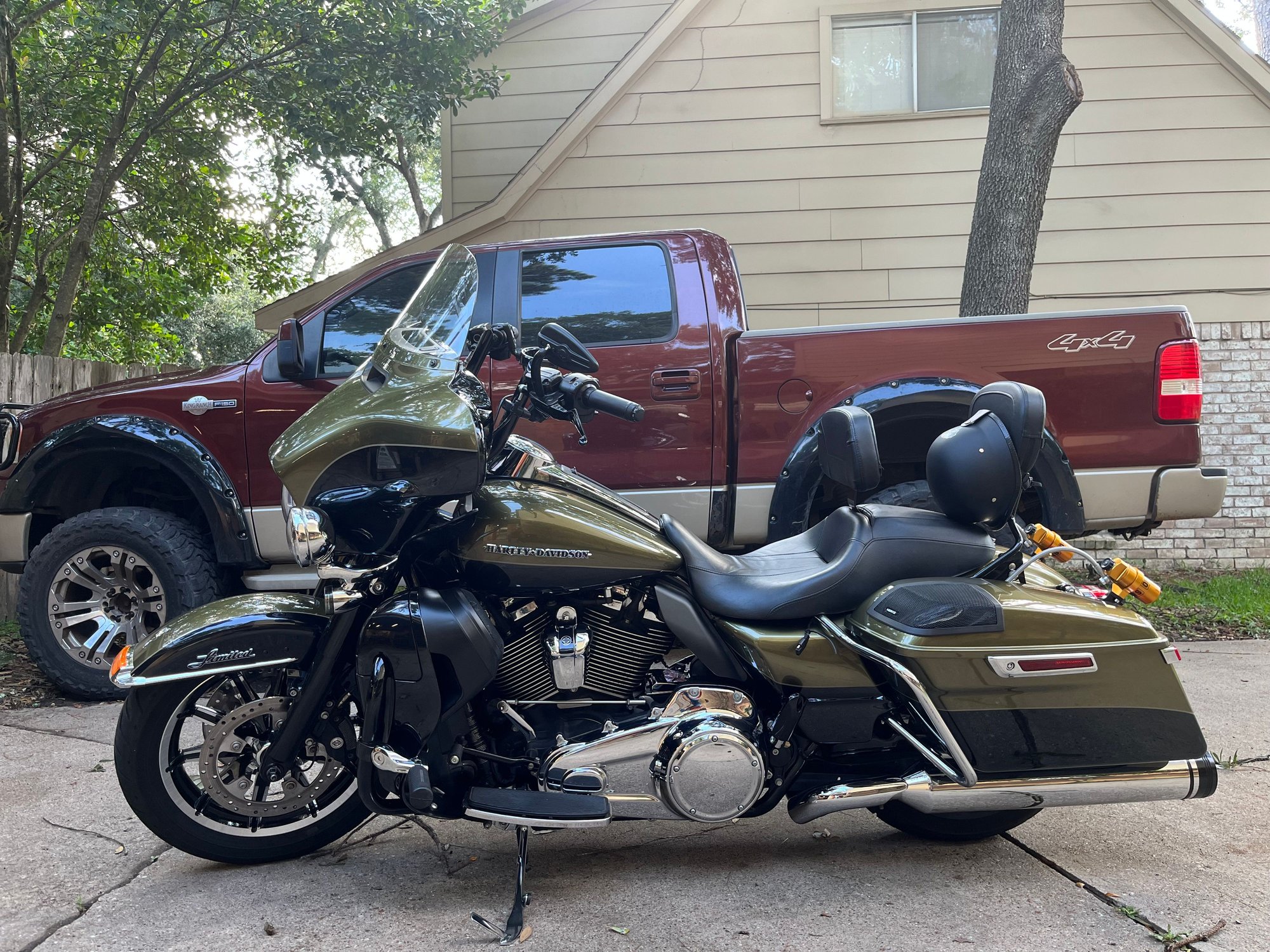

I finally got my shocks delivered and installed them on Saturday morning. Initial thoughts are that they are nice but I do not have enough seat time for a proper evaluation. Hopefully this weekend I can put some miles on them. Set sag per Ohlins website at 3mm for my weight. Have not played with compression or rebound yet.

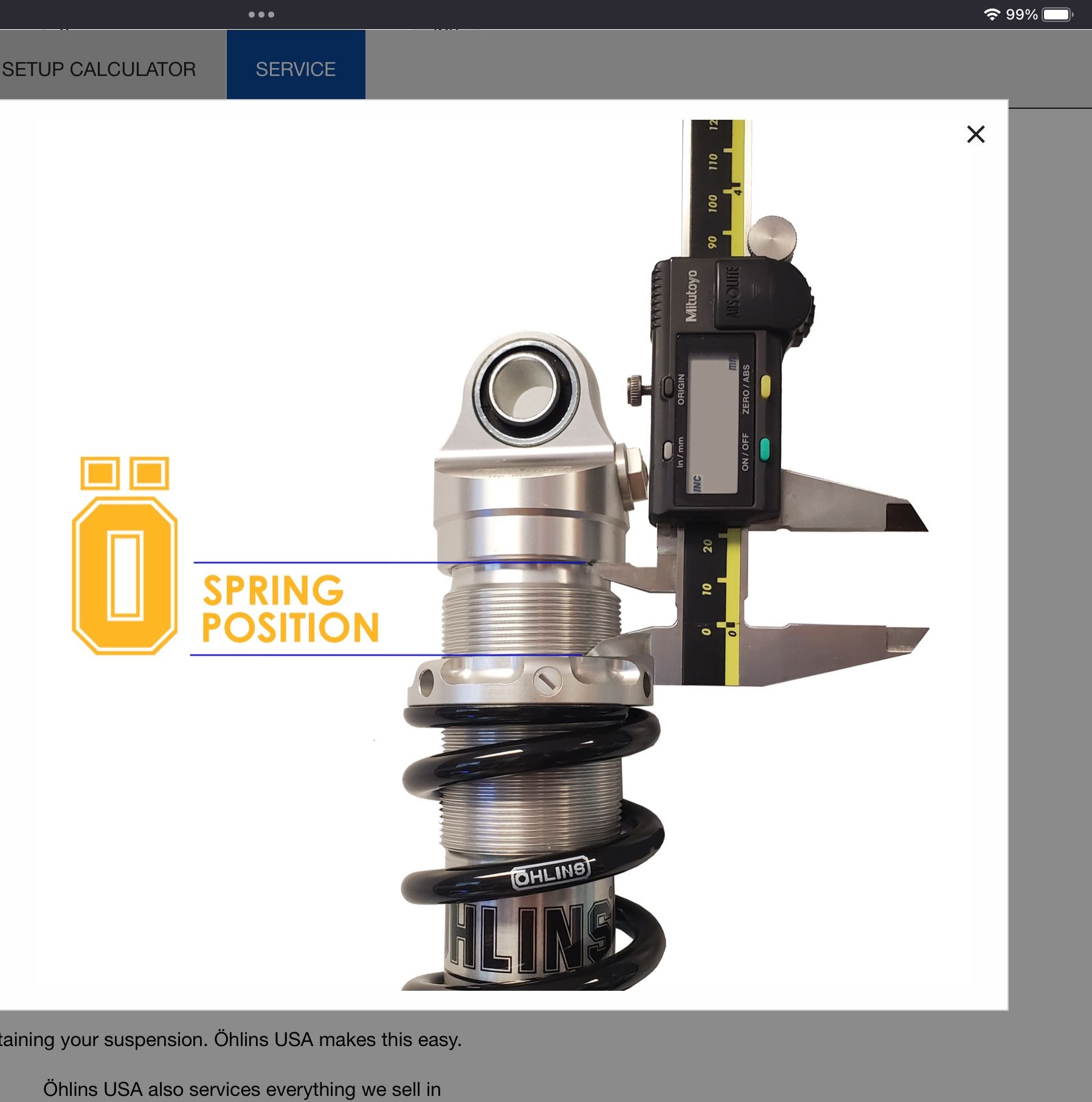

Thanks guys for all the input. I am confused on a few things however. Using Ohlins calculator on their website. they sag I should have 3mm of preload. Using the sag method, i have 14mm of preload. That's quite the difference. Now I always set sag on my sport bike at 1in geared up. So what am I missing? With 14mm Im at 1 1/8 sag.
Old Jun 23, 2023 | 09:19 PM
dajogejr's Avatar
dajogejr
Joined: Aug 2014
Posts: 1,703
Likes: 909
From: SE Michigan
Here’s my input. Forget about trying to measure sag.
Put your bike, specs and weight in the calculator.
Set the preload based on the top of the adjustment collar to the top of the threaded area…. Here’s the measurement.
