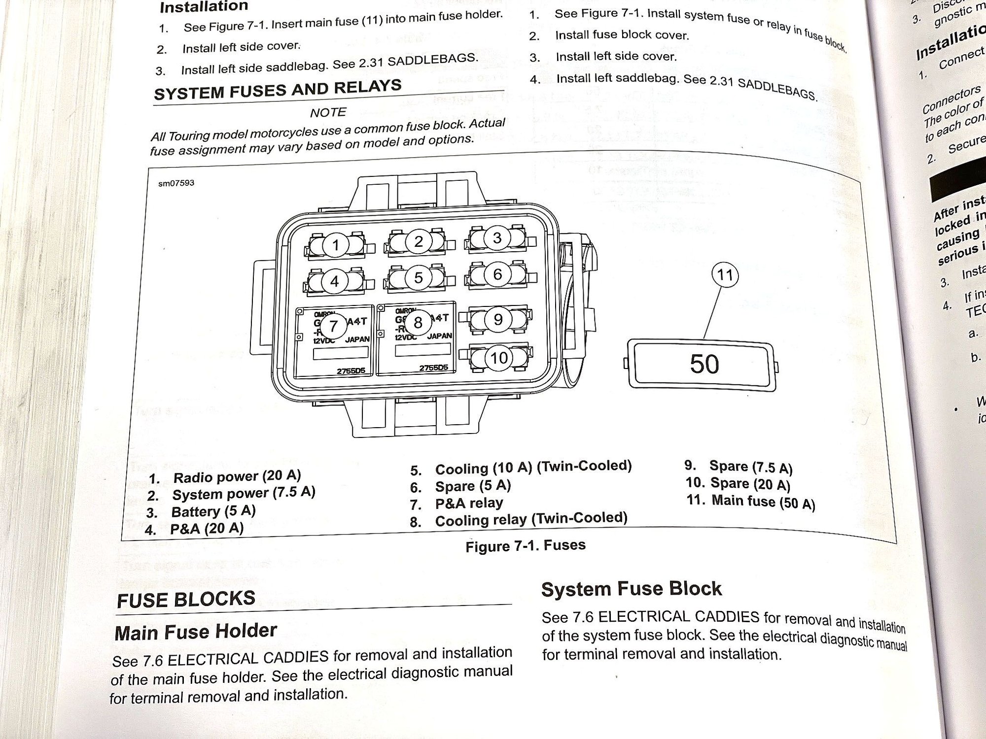

Check the yellow 5 amp fuse at position number 3. That's the one for my '16 Ultra Limited.
After that, check if you have power to the horn. There are two female ended wires on the back of the horn.
Is anything else not working? Such as the odometer, cruise control, fuel gauge?
Did you change bars or anything lately?
