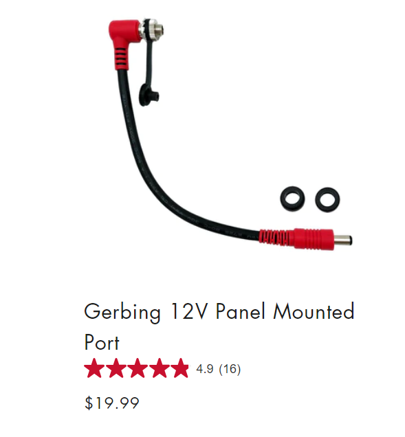

Default 12 volt panel mount
Anyone installed one of the these at the lower point of dash and ran wire under the seat?

Not that specific one, but I have used these:
https://lockitt.com/12v-outlet-euro-coax-plug
I have one mounted in the left side thigh heat shield on my Ltd and other one mounted in left-side speaker pod for the GF...look like factory OEM...

Which end connects to the battery? I assume this is for heated gear?

I have the Gerbing one mounted on 3 different bikes. Only takes 1 hand to plug in or out. No more wire hanging from seat.

I have one ordered and on the way. I've resisted this for a while - I'm likely to forget to unplug it and hop off the bike and tear something up
Yes...heated gear and battery charger can plug in with an adapter cable...
Coax plug end connects to another cable which goes thru a fuse (+ lead) directly to the battery...the additional cable comes as an accessory cable with the Battery Tender...
Battery to panel mount female connector:
https://gerbing.com/collections/heat...44879348859171
Battery Tender SAE connector to male coax to panel mount female coax:
https://gerbing.com/collections/heat...44879374680355
