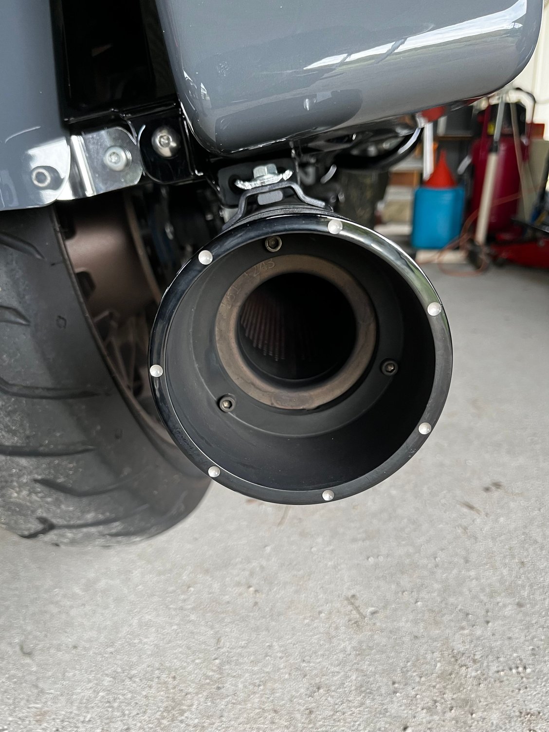

Originally Posted by Slingshot383
Are the DB reducers in? That would be the starting point. Also, they are quiet at idle but bark when the throttle is opened up.
thanks for information
here’s pic of end pipes not got round to taking end cap off yet

Can't be sure, but that looks like the end of the DB reducer in the pic. They are only about 6" long, slide right out of the baffles, will take longer to pull the screws out than pulling out the DB reducer.

Agree that it appears the reducers are still installed based on that picture.

Those look similar to my FM Jackpot Street Outlaw slip ons, the DB reducer can be removed. Personally I like the DB reducer as is better sound than stock while still easy on the ears.
