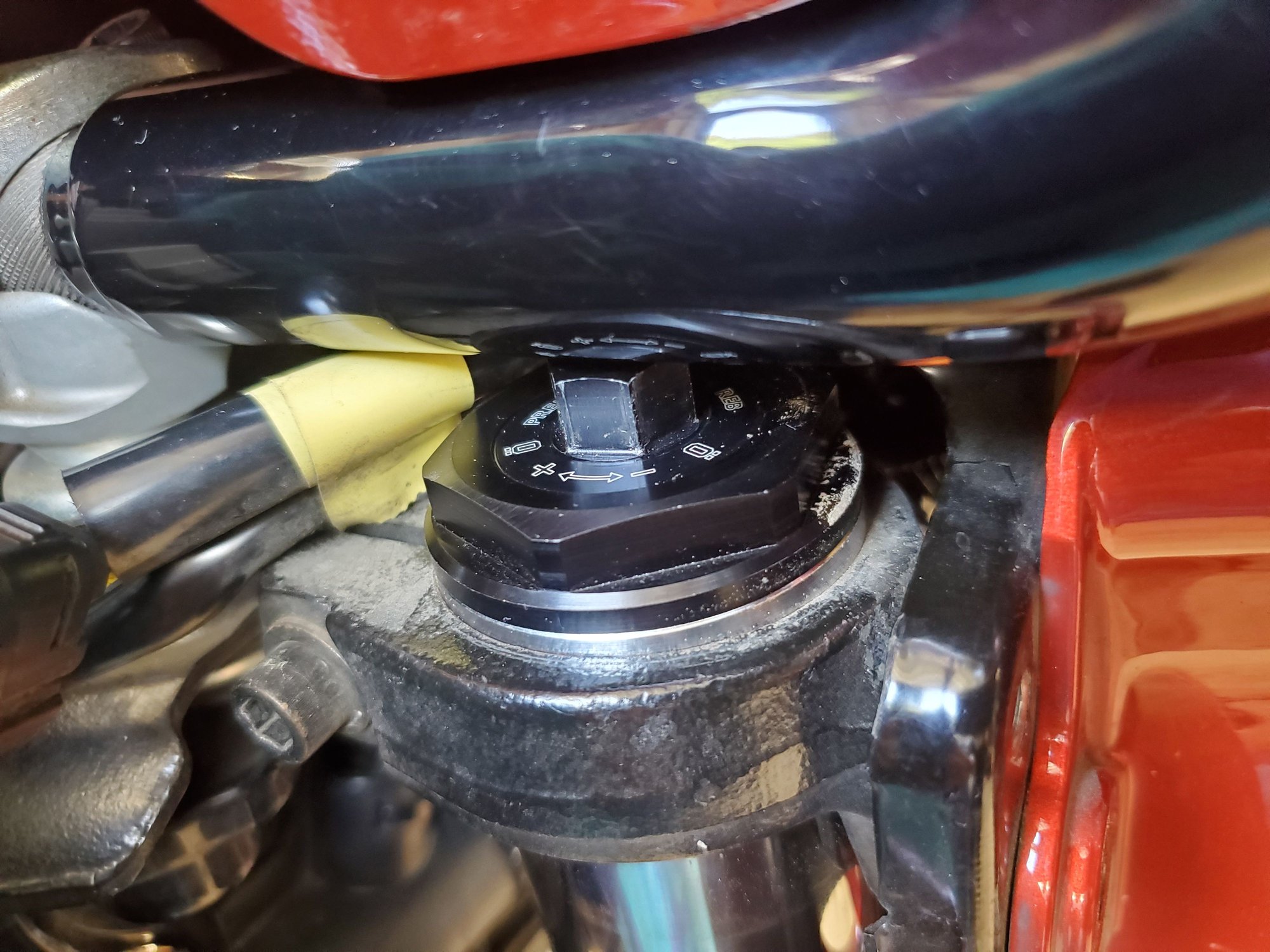

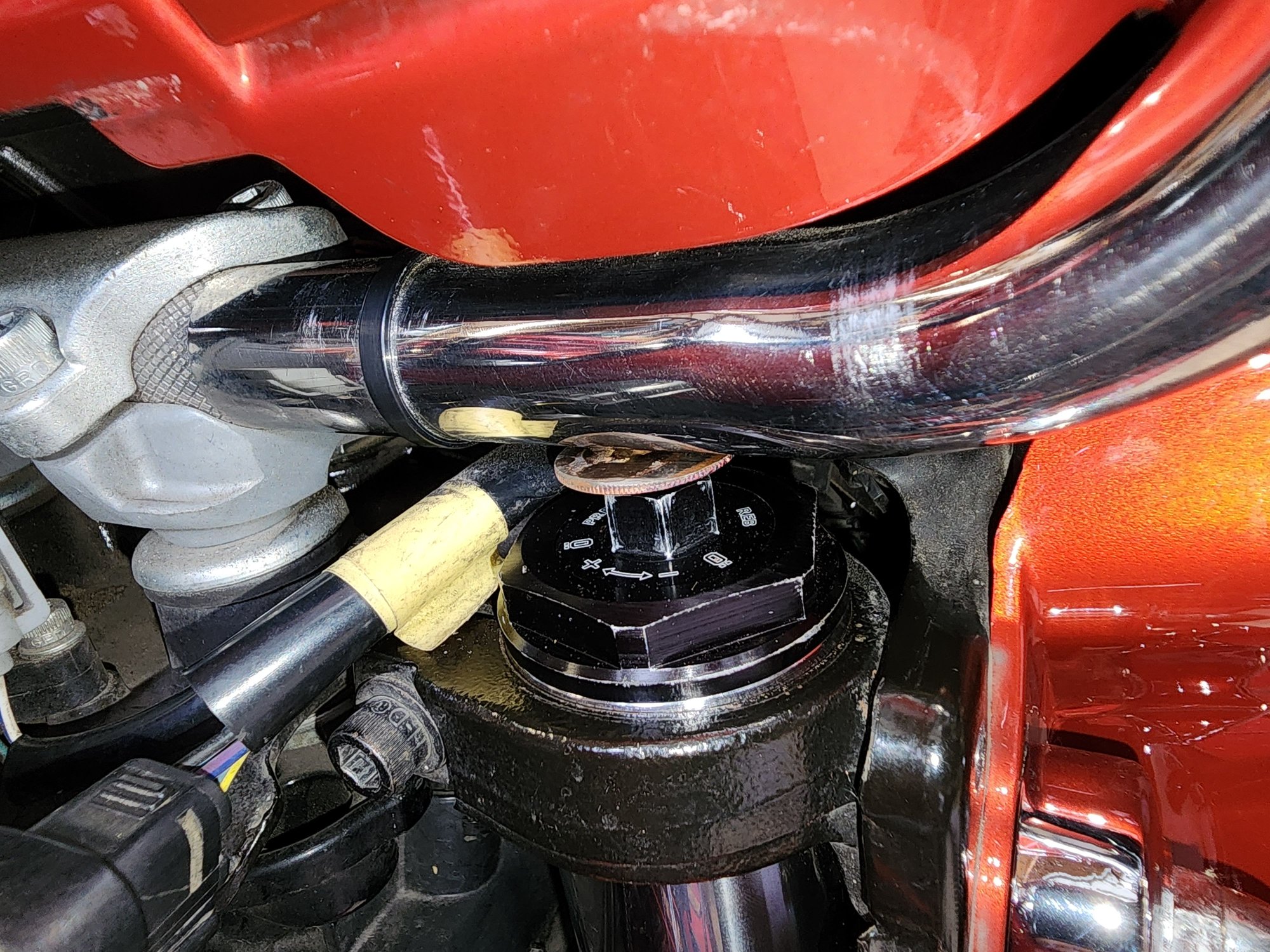

Originally Posted by rauchman
Also, in looking at the adjusters on the fork cap, looks like a special tool is needed to adjust preload. Based on the very limited space between the bottom of the handlebar and the fork cap, I'm not sure it's possible for the tool to even reach the fork cap to adjust.
So, I had Kevin from Big Bear Choppers build these NIX type cartridges for my 14 SGS and after loosening the fork tube clams a few time to adjust rebound/compression, (preload can be done with an open end wrench), I decided to drill out two quarters and braze a small piece of a 3mm allen wrench to them, put them in the adjusters, and reinstalled the forks. Now I can grab the quarters with the ridges on them and adjust to my hearts content. Just need to remove the dash panel for the switches to gain access to them. Saved me a lot of hassle!
Add edit- I changed handlebars between pics.......
do you have to pull the bars to get to the Allen adjustment??
