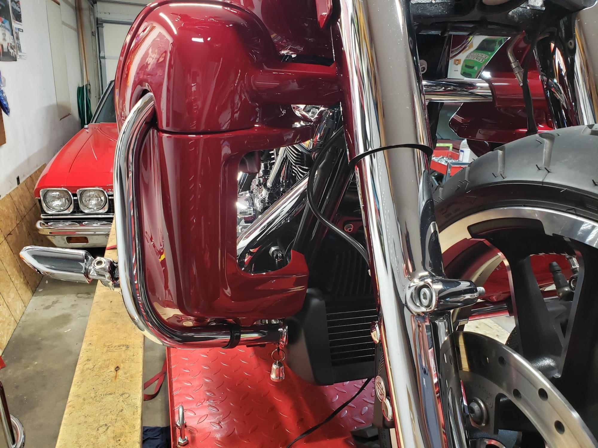

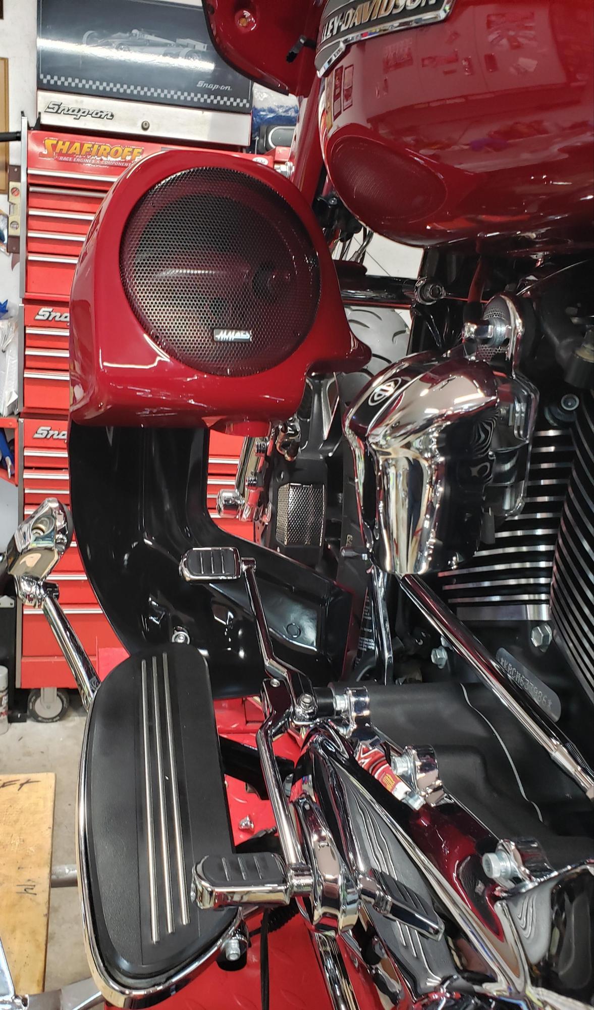

Originally Posted by rbeamj
Update:
had the bike checked out.
there was a large intake leak on the rear cyl. We replaced the manifold
as for the overheating or running hot. It’s a lack of airflow due to the lower fairings. I installed love jugs and that cools off the engine significantly. When the temp is below 320 the bike runs amazing.
so now I need to find some replacement speaker pods for the front or move my lower speakers to the saddlebag lids.
I switched from the Rushmore style lowers to the old style lowers and took the doors off. The old style without the doors move a lot more air...
Old Nov 13, 2024 | 12:39 PM
rbeamj's Avatar
rbeamj
Joined: Mar 2014
Posts: 303
Likes: 16
From: Stockton, CA
I may have to do that!!!
my lowers have much less airflow
