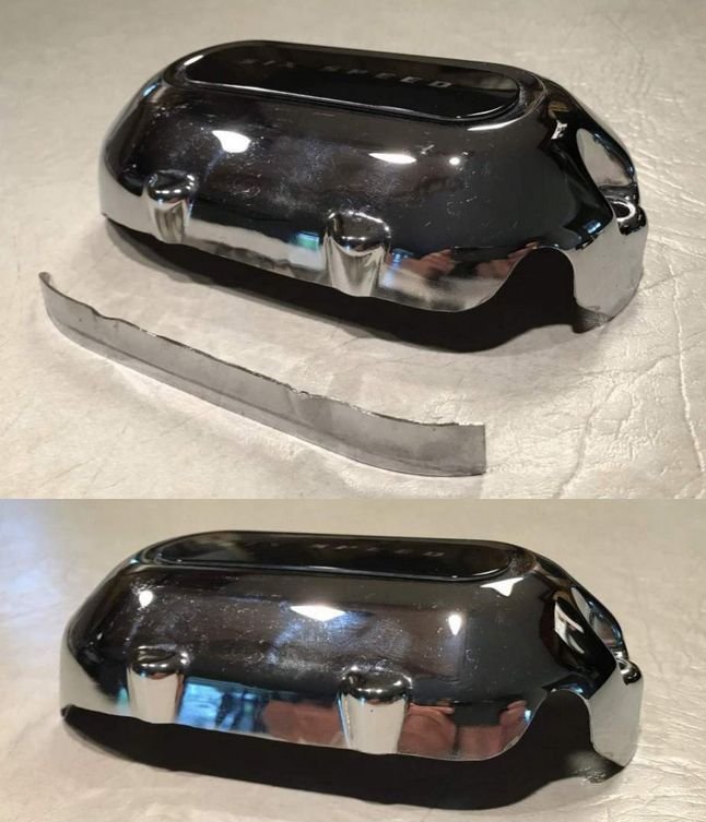

Clutch is getting little stiff, so I got to blead it. Mu question does anyone make a side cover with a hole or split in half. I ask because its a pain in the a-- to remove the cover now because the exhaust iis tight up agents so you got to loosen it to get it off. All it covers is the bleader valve.

There are threads about cutting the existing cover to make it easier to remove and install it in the future.
i did, happy I did! I change the fluid every 2 years.
I haven't done it because with my exhaust I can get the cover off... but if I had to loosen or remove the exhaust, I would seriously consider cutting the cover.
Here's a pic I captured from one of the threads on the subject. It shows how much was trimmed in the top pic, a just another overview of the trimmed cover in the bottom pic.
