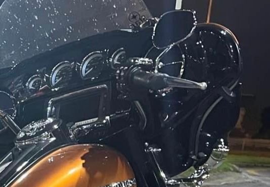

My bars are straight up they do not have a lower bend in them. I thought they did but after a closer look I saw they didn't. Have to find the bars here in Canada, exchange rate is a killer

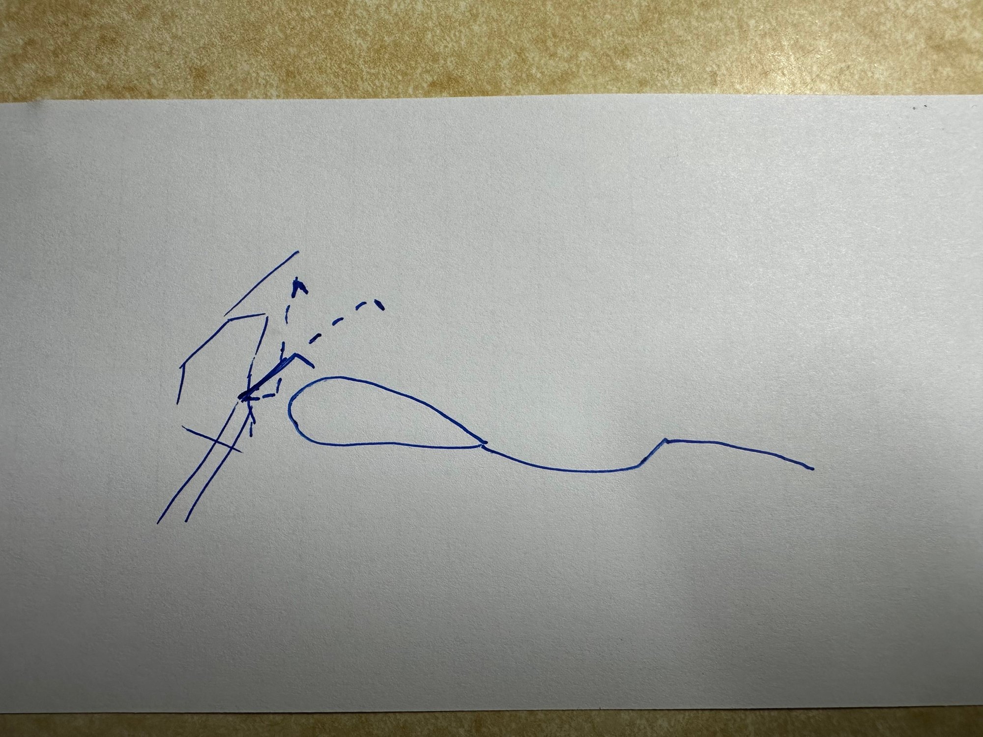

so it seems the factory bars may not have the bend but if you think about it when you put longer bars on, they’re gonna be way farther back away from the fairing that’s why the taller bars have that bend. Otherwise you’re gonna be eating your grips

Originally Posted by Jersey Drew
something is not right. Do you have a road glide limited? Because anything with a batwing fairing should have the bend at the bottom. Post a picture of your bike
no it’s a 2015 ultra limited, I hate the shark faring

Please remember i am not an artist and you got that up before i changed my post.

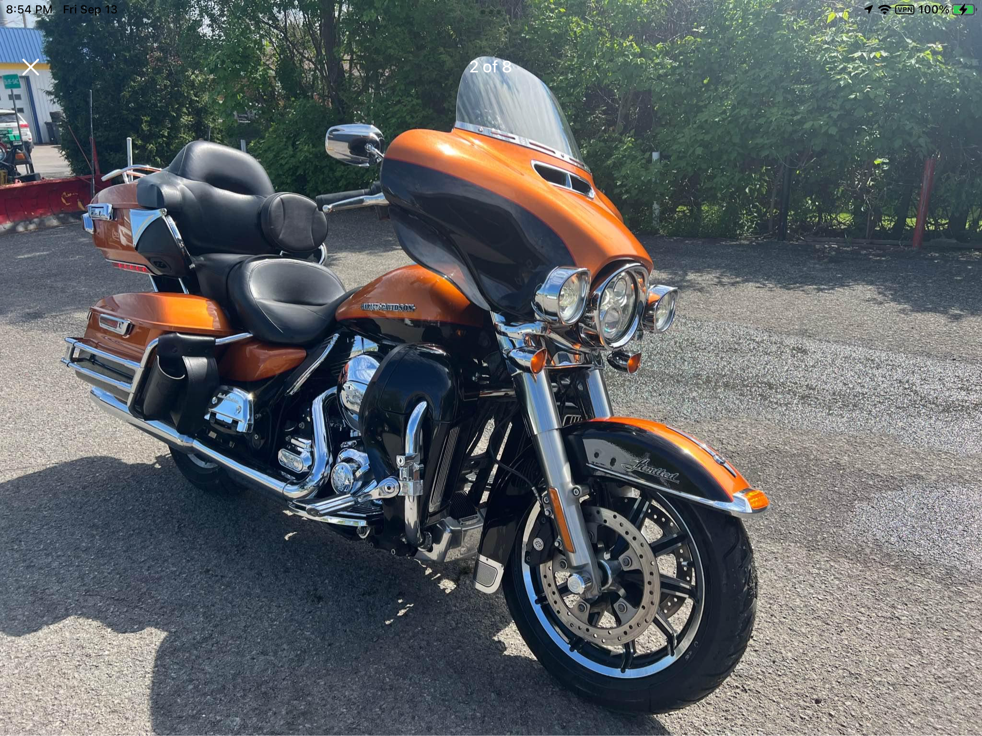

Look at my second pic I should have room to put them straighter up. Only want to go 10-12s.
no one is stopping you just remember they will be a along that angle and much closer to you. Also because of the way the bars are drilled. You may have to break off the nub in the switch packs so that your clutch and brake lever will line up at that height. this is because on a road glide the bars are meant to go more straight up and down and will probably have the wrong angle for your brake and clutch lever at that extreme angle back. I hope you understand what I’m trying to say
