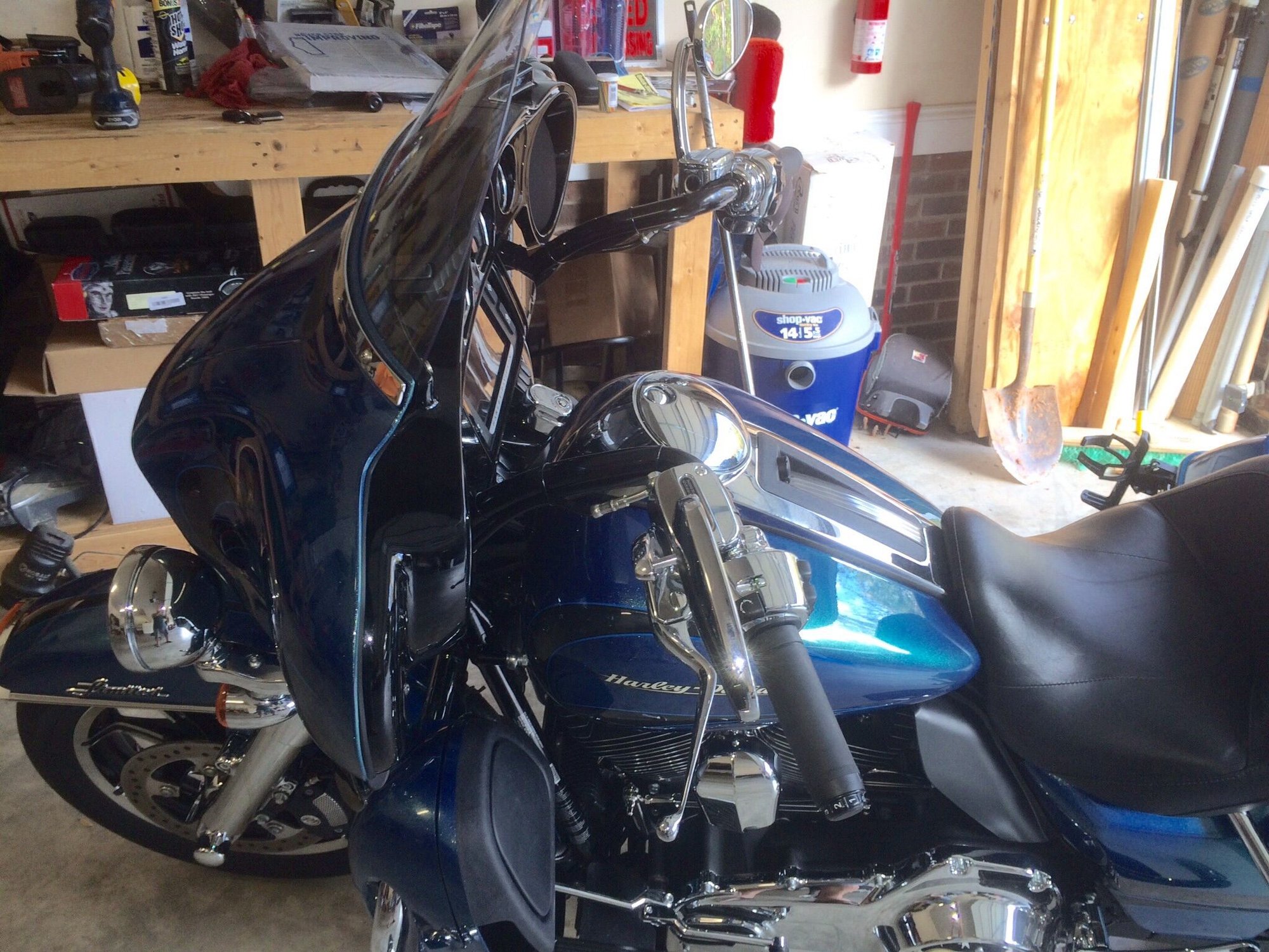

Just finished installing my Khrome Werx 2+2 sweepers on my 14 Ultra Limited. Followed JTs instructions and with the exception of a few pain points, the install went well.
Trying to re-install the ignition switch was a ROYAL PITA. And took me several hours to figure out. I'm still not certain what I did to get it back.
Also, you have to make certain that your brake lever is engaging the little switch in the housing (ask me how I know) if not, you're brake light will remain on and not shut off. Perused the forums for help on that one.
No extra cables were required!
I'm not a wrencher at all but I sure as hell wasn't gonna give my "stealer" 1200 bucks to install an 86 dollar set of bars so I went with it. Glad I did.
