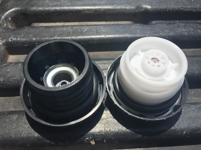

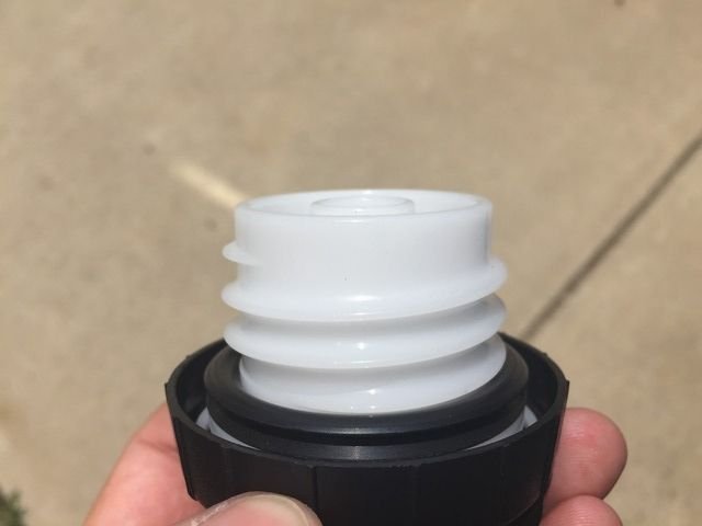

People don't bat an eye at thousands of dollars to replace stuff, but a $4 gas cap has your goat?
Stock on the left, Stant on the right
The Stant is 1/16" smaller diameter than stock. That's a tiny amount, but all the world of a difference.
Just in case anyone is wondering ---- The gasket is exactly the same.
Stamped 1004
