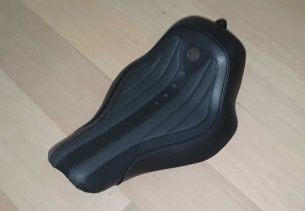

My customized seat is done, I am very satisfied with the result, it is completely made according to my drawing and couldn't be happier.
I based it on my swingarm bag and wanted the same look and materials. The only downside now is myself, the recovery from my back
surgery is very slow and I am not allowed to ride a bike for at least another 2 months.

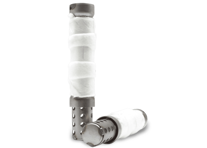

Originally Posted by Urban Gorilla
I seem to remember that Fran used some scientific theory with regards to the position and installation of the DK Custom TTI's.
I've trawled through some posts but can't find the info.
Can you remind how you did it please?
So you have Short Shots on your bike atm right now correct?
Do you have Baffles in them?
If you have the Baffles in the pipes currently, you need to pull them out and check them. If they are the baffles I think they might be, they will have a Torque Disc at the front end of them.
It should look like this:
If your Baffles have this plate at the end you need to cut out the plate. You can also get some muffler wrap and wrap that forward section to help deaden the sound even more.
Then you need to measure the internal diameter of the baffle, and determine the size of TTI that will fit. It seems like it should be 118W. DK has a chart here: https://www.dkcustomproducts.com/cho...ue-inserts.htm
If you don't have baffles like that in your exhaust atm, you will need to check to see what kinds you have.
Placement of the TTI matters on the kind of baffle exit, if the baffle is the same diameter the entire way through and does not flare/bell out at the end then you just measure 1inch from the end of the pipe, measuring from the farthest inward part of the slash cut.
Then mark out where you want to Drill based on how far back from the stud the trailing edge of the TTI disc is. You will want that trailing edge of the disc to be even with the 1inch back marker, or close too it.
If your Baffles have Bell/Flared ends, you will want to measure how far back the stud is from the trailing edge of the Disc, and drill the hole for the stud so that when it's placed in the baffle the trailing edge is even with the start of the flare, or just infront of it by 1~2mm.
The purpose is that you are trying to create a drop in density right after the TTI is creating low pressure velocity increase. The double drop in pressure will create more scavenging, and prevent more reversion.
The Exhaust squeezes past the TTI and the velocity increases, as the pressure decreases. When it dumps into the bell flare, it has an area to expand into preventing an increase in density, and the exhaust pressure will push against the TTI and flare and this will reduce the exhaust pulse's ability to reverse direction and pollute the new cylinder charge.
Basically you place the trailing edge at the beginning of the flare so that the TTI will decrease pressure while increasing velocity, then the bell flare reduces pressure even more as the higher velocity gas expands into it, which in turn makes it easier for the exhaust gases behind the TTI(that have not passed through the TTI yet) will more easily exit the system, while the TTI prevents reverse from the pulse wave.
If you place the TTI too far into the flare and it sits in the flare it wont cause the exhaust to squeeze past the TTI and increase the velocity.
If you dont have any baffles at all in those pipes as they are now, then you simple want to measure 1~1 1/2 inches away from the shortest part of the Slash Cut and place the TTI so that the trailing edge of the Disc is just about 1inch away from it.
Just make sure you measure the diameter of the pipe and get the right sized TTI for them.
