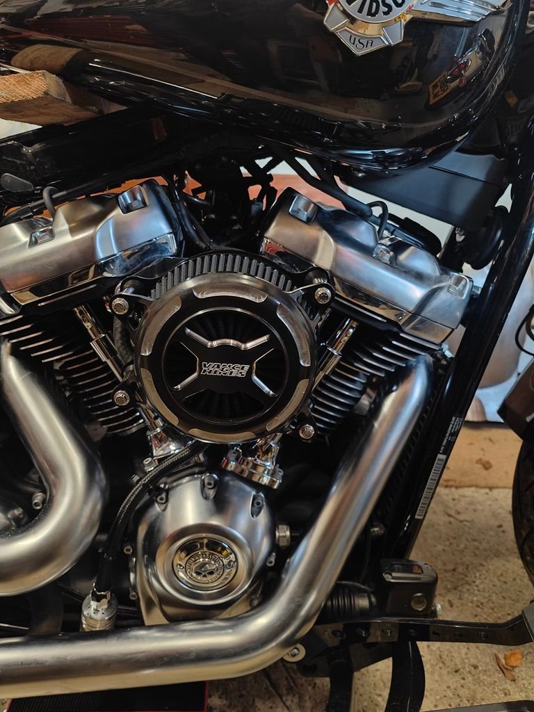

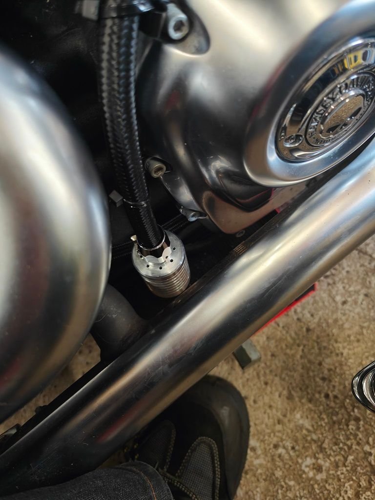

Today I installed the DK Customs Breather Kit
and V&H V02 X Air Cleaner Kit

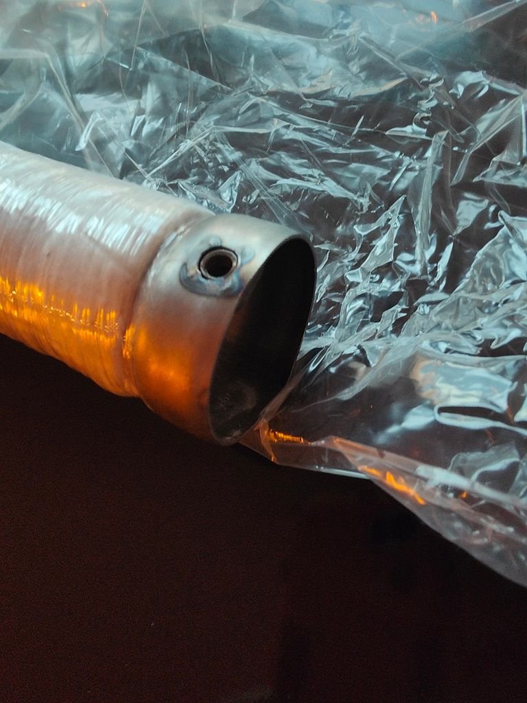

Originally Posted by FranBunnyFFXII
Just make sure you measure the diameter of the pipe and get the right sized TTI for them.
So the diameter of the pipe is just over 2" at the exit, so if I was running without baffles then the TTI 158's would be right.
However, I checked the V&H Quiet baffles (21912) that I have and the diameter at the flared end is 1 7/8".
So, if I run with these baffles then I'm guessing that I'll need a set of TTI 118's

Yeap. If you wanna run the baffles, chop the disc at the end out, and get 118W's.
I'd also wrap the extra end over there too.
The exhaust note, that high pitch "Twip" sound that comes out the muffler with those TTIs in it sounds so ****in good mixed in with the rumble.
When you roll off the throttle you should be able hear a deep gurgle, that's the soundwaves bounding off the TTI, it makes engine braking sound pretty cool.
I hope these short shots sound just as awesome once you're done.

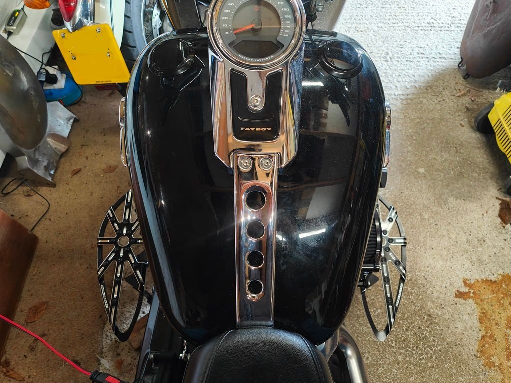

Today I installed my Arlen Ness Floorboards
