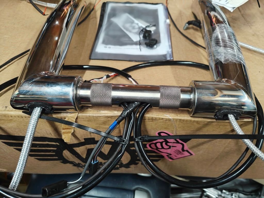

Cheers....much appreciated.
All the Control Switch cables, hydraulic brake/clutch lines are already run through the bars
...I had a feeling afterwards, hence the post to confirm, that I should have run the extra wires for the indicators through at the same time.
Ah well...fun and games ahead!

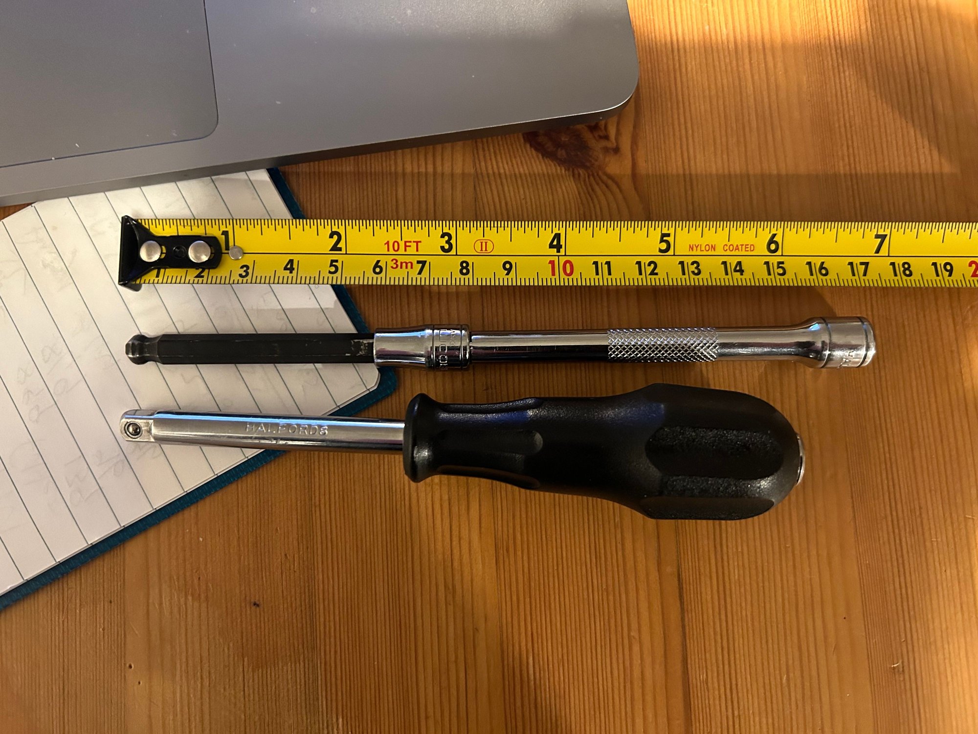

The bolts are actually quite easy really - if - you have the right tool.
What you need is a long ball-ended 1/4" imperial hex key, that you can cut/grind the L part off. Or, a long 1/4" drive socketed 1/4" hex key.
Ideally the 1/4" hex needs to be 220mm to do both sides of the flanges without needing to remove cooling hoses etc. Or, at if it's at least 55mm or so it will get to the bolts without the socket on the end rubbing against engine bits and making the angle on the bolt head worse, from that you can make up the rest of the length with your 1/4" socket set extension bars, just make sure your extension bars are 1/4" not 3/8 or 1/2" (pic of mine attached)
The other awkward bit was (without stripping down the engine a bit) was wiggling the manifold out - I disconnected it all, then had to take the whole fuel rail and injectors off to be able to wiggle it out the right hand side of the bike.
PS I did get new intake flange seals as the book recommends, just for peace of mind.
Hope this helps

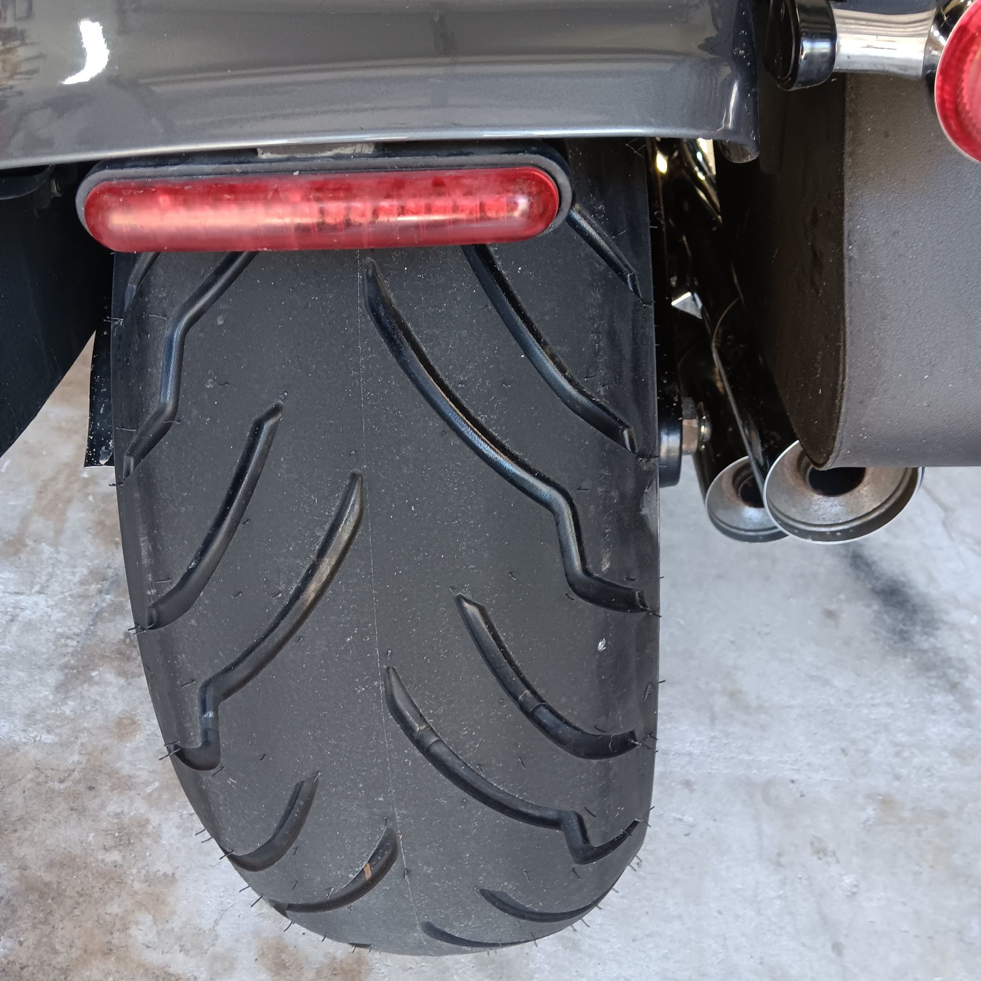

I installed a new tire on the back, a Dunlop AE. It had a Metz 888, got 9K miles on it, I should have changed it earlier, it was real thin. I do it myself with spoons, and Motion Pro hand bead breaker. I really worked up a sweat, then a static balance. 20,600 miles total on the FB.

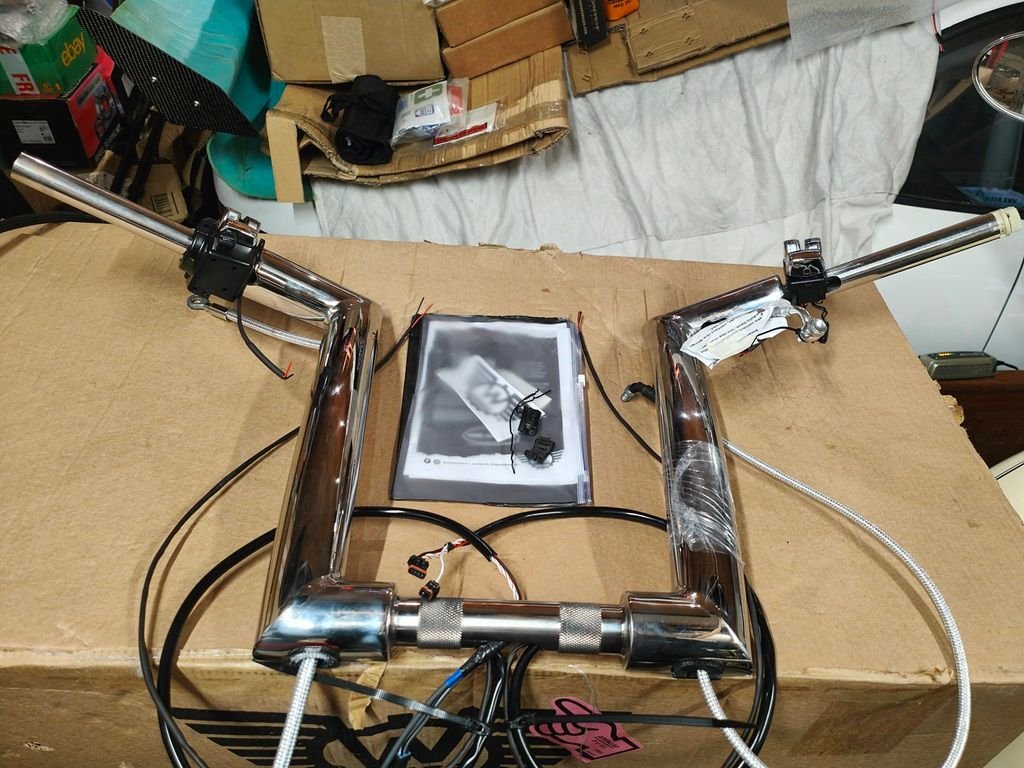

Last weekend I completed running all the wires inside my bars and got the chrome switch caps on
