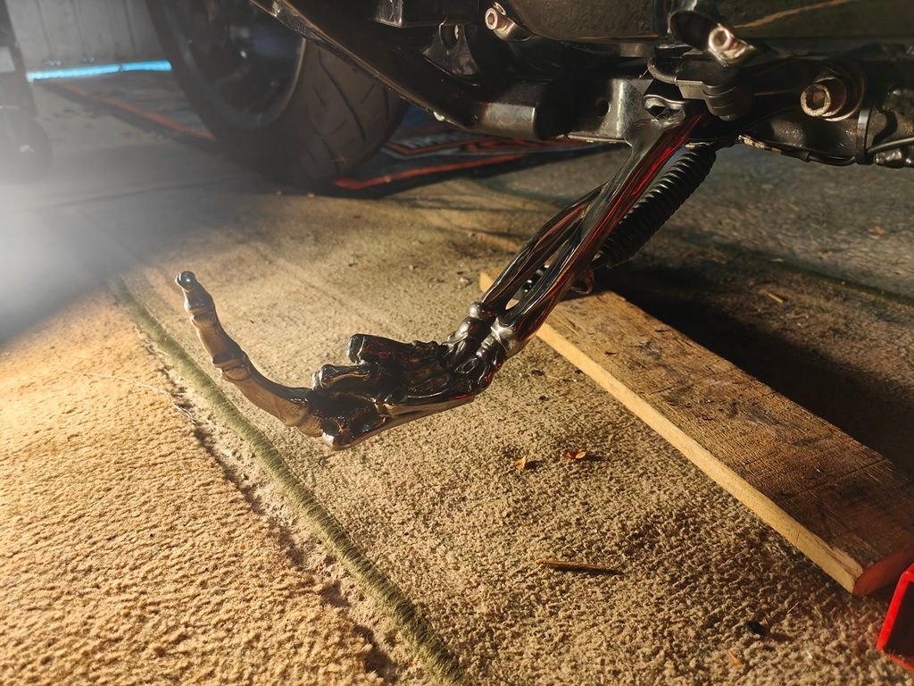

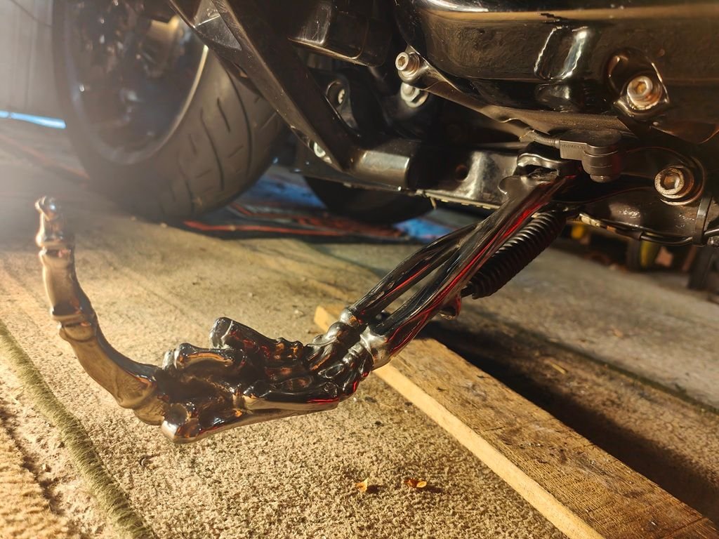

The good - fitted my Image Motorcycle Products, The Salute Kickstand

That's a pretty funny kickstand.
How did you handle swapping the spring on and off? I had to ride to the dealership and have them do it.
Yeah, not for everyone but matches in with the skull theme and skeleton wing mirrors - I had one of these on my old Evo several years ago, spoke to Image who said to hang in there as they were developing one for the M8. Not cheap, especially with the shipping costs and duty, but it'll be pretty rare to see one over here (in the UK).
Really straight forward...
I completely removed the kickstand from the bike so I could work on it on the bench.
I then, using a fine tipped screwdriver, went along the entire length of the spring, prising the spring open and inserting penny coins down the front and back of the spring - this stretches and releases the tension on the spring so that you can remove remove it using some pliers. More importantly, it makes it so much easier when putting the spring back on - again, using pliers but with very little effort.
(Can't take the credit for this method - I found the technique on YouTube somewhere).
This is the kind of advice I love this forum for. Thanks Gorilla. I still have to install that kickstand fix kit, but haven't because I wasnt sure how to handle putting that spring back on.
I was thinking about just assembling it and putting my lift in the backpack again and ride back up to the dealership and have them put the spring back on.
Doubt they'd do it a 2nd time for free though lol
