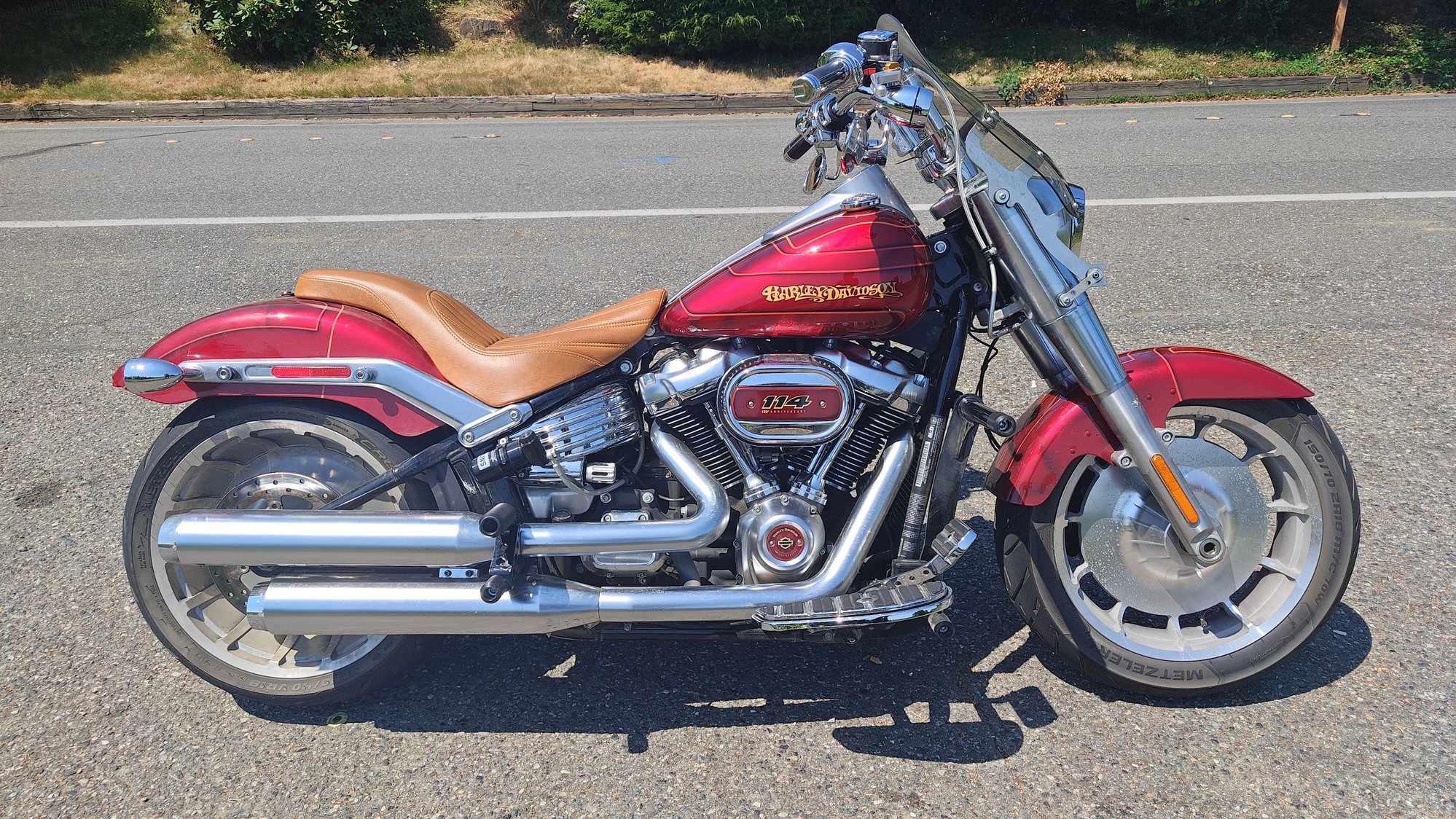

Originally Posted by FranBunnyFFXII
So I've had this big guy for 3 years now.
What Bars are those on your bike, also what cables needed to do it?
Old Dec 21, 2024 | 05:53 PM
  #1837
FranBunnyFFXII's Avatar
FranBunnyFFXII
Veteran: National Guard
Joined: Oct 2018
Posts: 4,347
Likes: 3,392
From: Seattle
Those are a Modular Prototype that I assembled.
They are made from Arlen Ness 1.25inch Chrome Modular Clamps, a generic set of 1.25inch 12inch Ape Hangers chopped down to be as low a rise as possible.
I chose 12inch rise to make sure I got enough up pitch angle on the uppers segments, so when the center segments were cut out they would feel nice in my hands when pitched back significantly.
They total 8.5inch rise to the center of the handle segement bars.
I used the stock Clutch cable, and 26inch Magnum Shielding Silver ChromiteII brakeline with a 90 degree banjo fitting. My lines were damaged when my bike was illegally towed, but are still safe to use. I will be replacing the line with the same color but 1inch longer.
I also purchased but have not installed a stock length silver chromite 2 clutch cable line
Partnumbers from Magnuim Shielding.
AS37227 SCII Des ABS UP 27" 90° 10mm x1
AS37026 SCII '18+ ABS Adapter x1
32344HE SC Quick Connect Upper Clutch Cable x1
Old Dec 21, 2024 | 06:15 PM
  #1838
RKD's Avatar
RKD
Joined: Apr 2013
Posts: 23
Likes: 5
From: Houston, TX.
Great Thanks, I was looking at some LA Chopper 1 1/4" - 8.5 inch but they seemed to bit a bit wider, I like the look of your narrow bars. I also found some narrow 1 1/4" - 10 inch ones I that look very similar to yours that im interested in but don't want to go to high. The height of your look perfect for what I'm looking for, Did you have to extend the electrical any or just the clutch and brakes?
