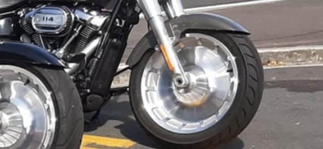

Its good the opinions we get on here as it doesn't hurt to learn. Looking at what they say a 150 tyre is good for a 3.50-4.00 rim and a 160 tyre is good for a 4.00-4.50 rim. The Fatboy has the 4.50 front rim, having said that I have attached a photo of a Commander 11 150/70/18 which has this front tyre and it looks good and from reports rides very well. It is a good option, but by the looks of it the tyre may be supper seeded soon with the introduction of series 111, which does not have this size. Time will tell
Good to see it fits well and rides well. He needs to reverse it though.
Siping and carcass needs to be inverted on the front.
Either way, at least its a good demo that it fits and rides well.
Thats actually a designated front but is a BIAS construction. Michelin have it listed. Looks good
Sorry I stand corrected it is a rear, see your view on the siping, it is wrong as fitted
