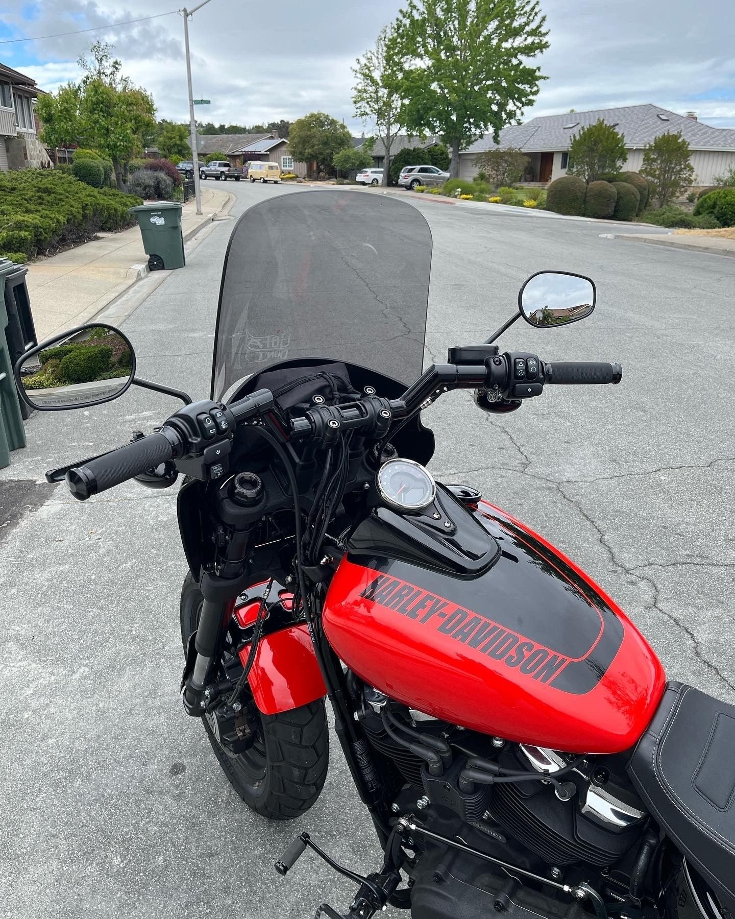

I installed the CJ Motorsports solid 2.5" risers shown here. With the Stock bars that's about as tall as you can go with stock cables and brake lines.
CJ Motorsports Risers
The Trask Moto bars are MUCH narrower than the stock Fat Bob bars, so even with the 2.5 risers and the rise of the Trask Bars there was plenty of cable and wire length. You do need to get Shims from the stock riser diameter of 1.5 to the Trask dia of 1.25. Harley used to have them on the website but now they are discontinued.
I'm 5.8" and the stock bars were a bit of a reach for me. I really like the look of the Trask and I think the angles and web bracing look right on this style of bike.

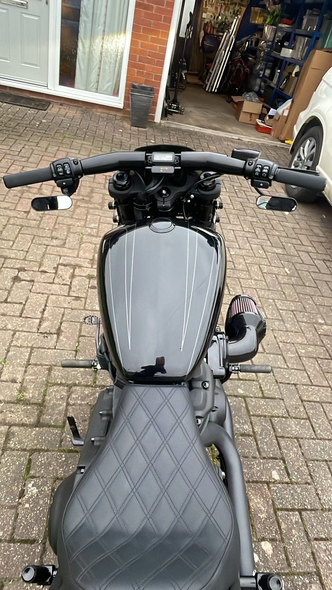

Work in progress
Top clamp to fit to the bars
Heat shrink on wiring
V happy but may have to modify the Memphis shades fairing to make it fit as these are slightly narrower with a lower rise and the clutch cable hits the fairing now and prevents it fitting!!

What ice learned with my relatively short time with Harley is when ypu change something there's always something else.Great socks by the way.Definately the best Harley socks on the market!!
