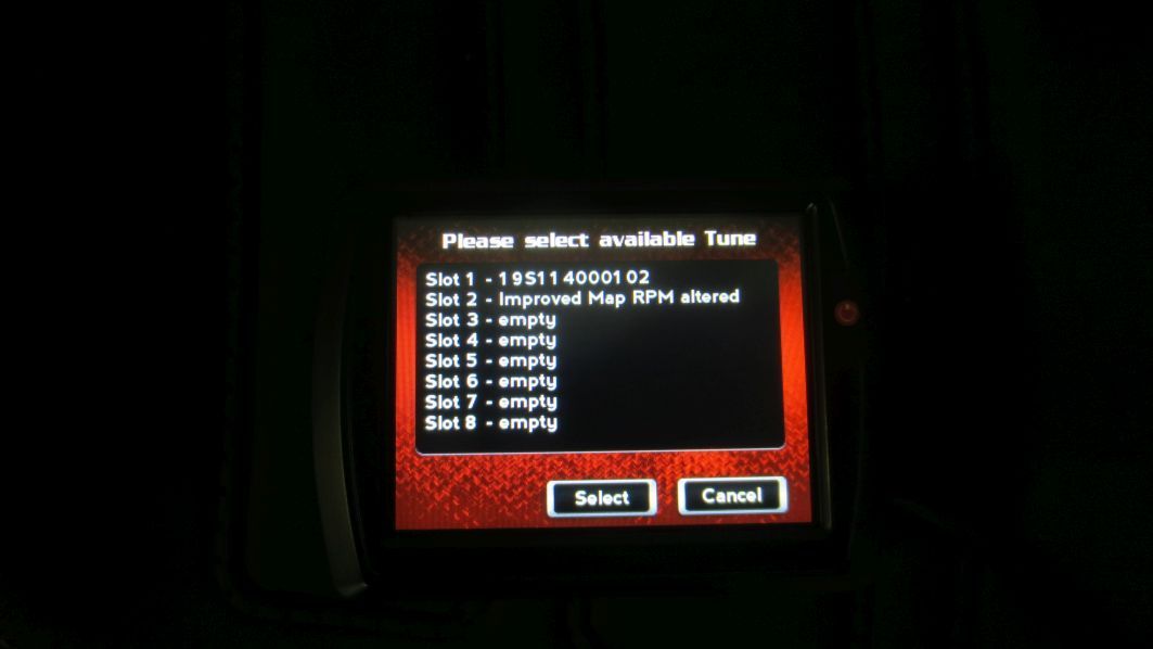

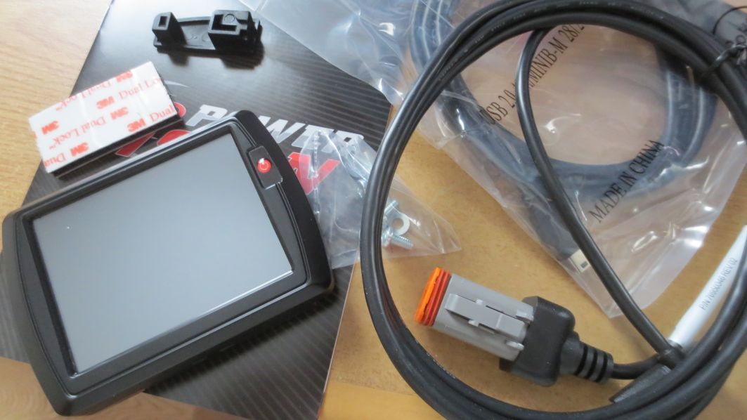

The PV arrived this morning, I just did a install of a Improved stock map with RPM set at 7000. The limiters where allready set at 255 so I did not alter anything there, the only minus for
today is the weather. It is raining so hard now that I can not do a testrun today and tomorrow is a country wide spread police speed marathon so that will not be a good day eather .

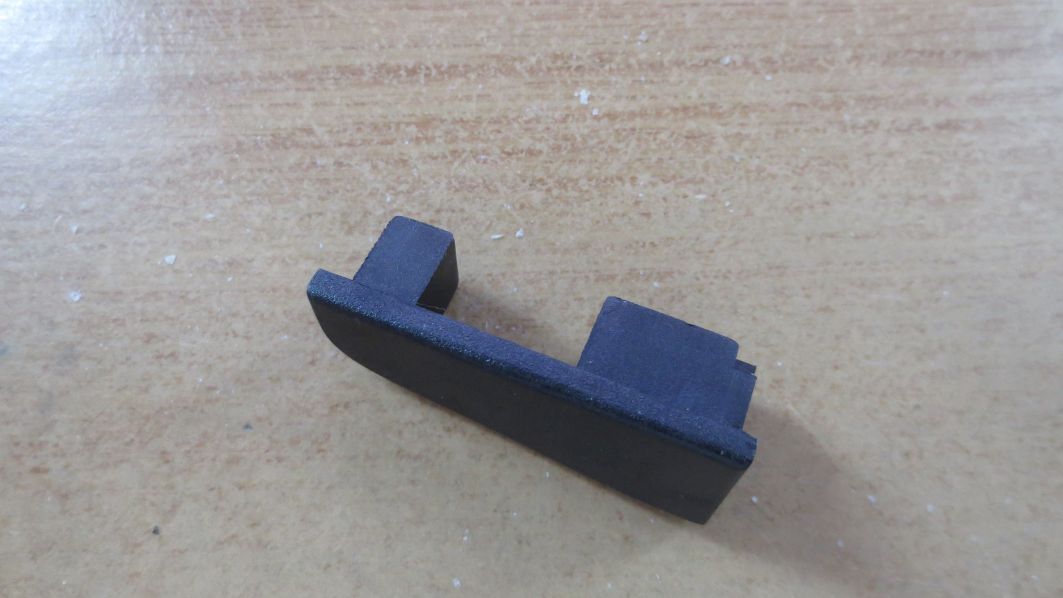

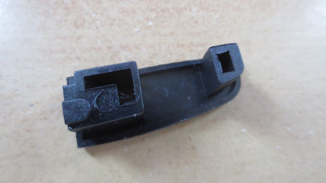

Oh yeah, found this in the PV box to, does some one now what it is for ?

Just the cover for the wire input onto the PV unit. Really not useful as you would only put it on when wire is not plugged in, in case your leaving it on the bike. I take mine off after auto tune or loading the map.

Thanks DonN, like you said ... not really useful.

Yesterday I did the first testrun on the highway after I flashed the "Improved map" with the limiters set on 255 kmh / 160mph , no higher speed was possible then before, on the contrary, I now have a
maximum speed of 183 kmh / 114 mph. Al so I had a excessive fuel smell when I parked the bike back in my garage.
So today I made a copy from the oem map in the ECU and altered the limiters again on 255 kmh / 160mph, a new testrun will not be for today bacause the weather is bad, plenty of rain and wet roads.
