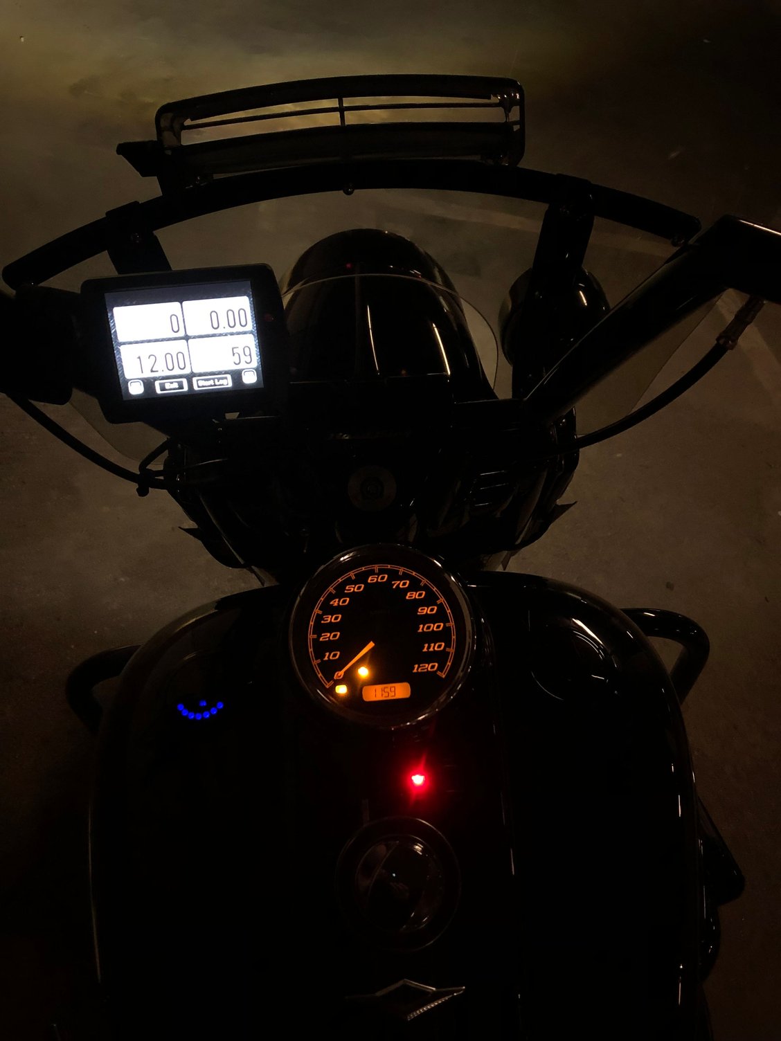

Its a flash tuner, so you can mod the tune all you want on your PC, save it to the PV, hook it up to the bike, flash it, and remove it. Nice thing is you can also leave it connected, put it on your handlebars and set it up so you have a nice set of gauges much closer to your field of view. Probably less important for models with the new digital gauges on the bar clamp, but for the gauge on the tank bikes, it really helps. You can also use it as gauges and read/reset (I think reset?) codes on any bike, even if married to another. I’ve got a couple old PV’s that I’ve used as gauges on bikes that weren’t eligible for a PV tune, like those wih EPA sensitive warranty concerns...
Like this on my Road King.

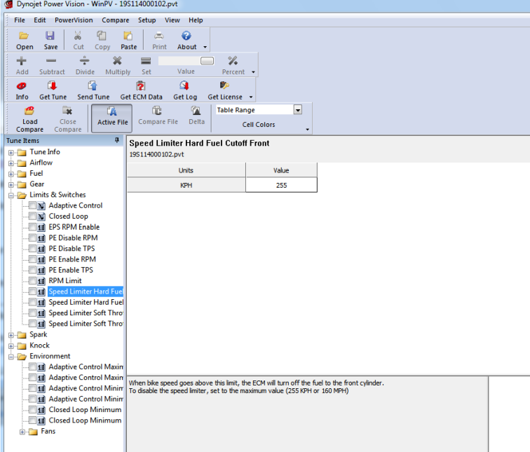

I was on the German autobahn and in top gear, so in 6th gear, it is like someone hold you back at 193kph. The engine sounds good and you feel that there will be more in it but
doesn't comes out.
I'll wait untill next week to see what I'm going to do. I already downloded the PV software and the map for FXFBS and under "Limits&Switches" there is a speed limiter that you
can alter. I al so emailed a local dealer where I have a 10% discount coupon to ask if he have the right PV for my FXFBS, I do not know if there is a difference between them.
Should this one fit my 2018 ?
The setting on the PV software I downloaded.
