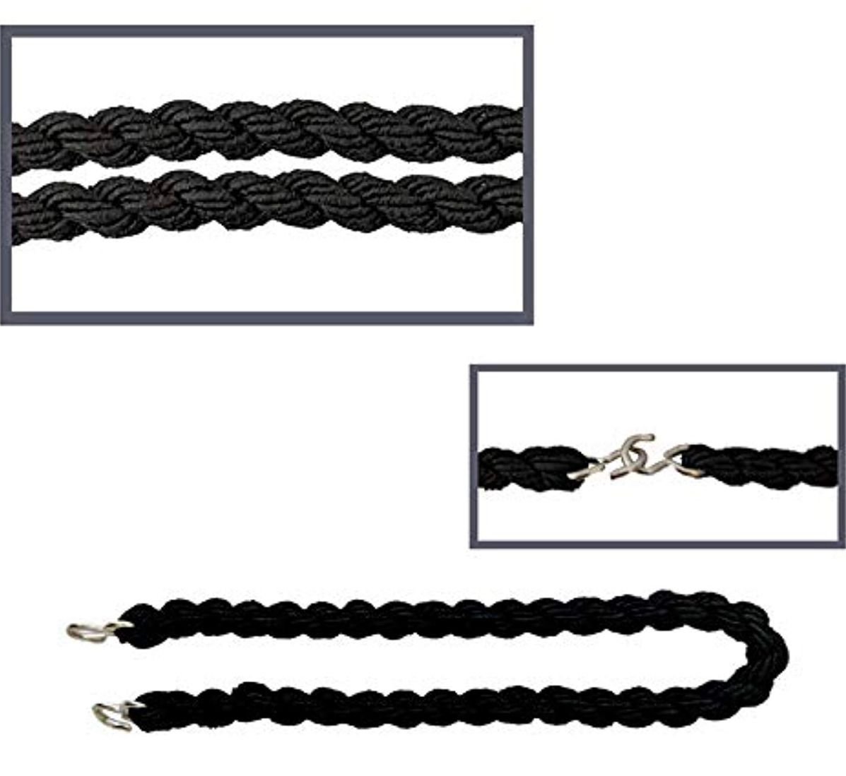

Not as handy at the tool bench as you are. Here is my solution:
Anyone who served in the military remember boot blouses? I had a few sets laying around so after having enough of that rattle in my face I tried a boot blouse. Hook it up after a fill-up and good to go!
