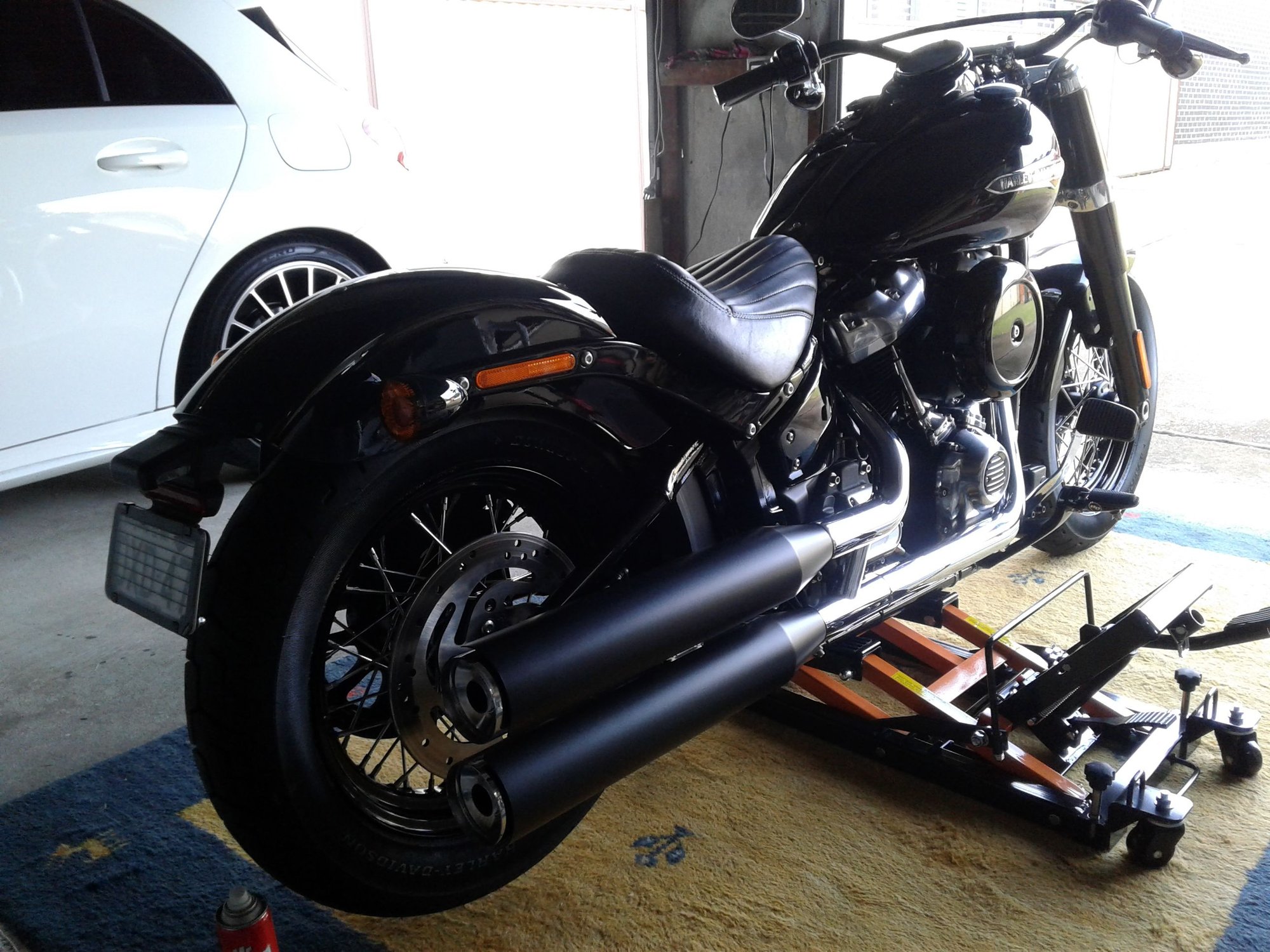

Easy breakout , fatbob, sportglide braket all the same m Ceck Ronnies OEM part fish
There you go

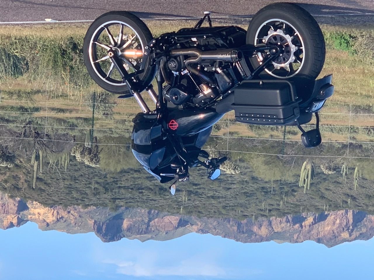

Default Someone’s unused floorboards
If someone ends up with slim floorboards, would like to get them. I would trade my mids plus a little cash. Or have a Corbin wall seat for 18+ slim or fxbb. I gained some legroom with tall boy seat, fwiw.
19 fxbb
