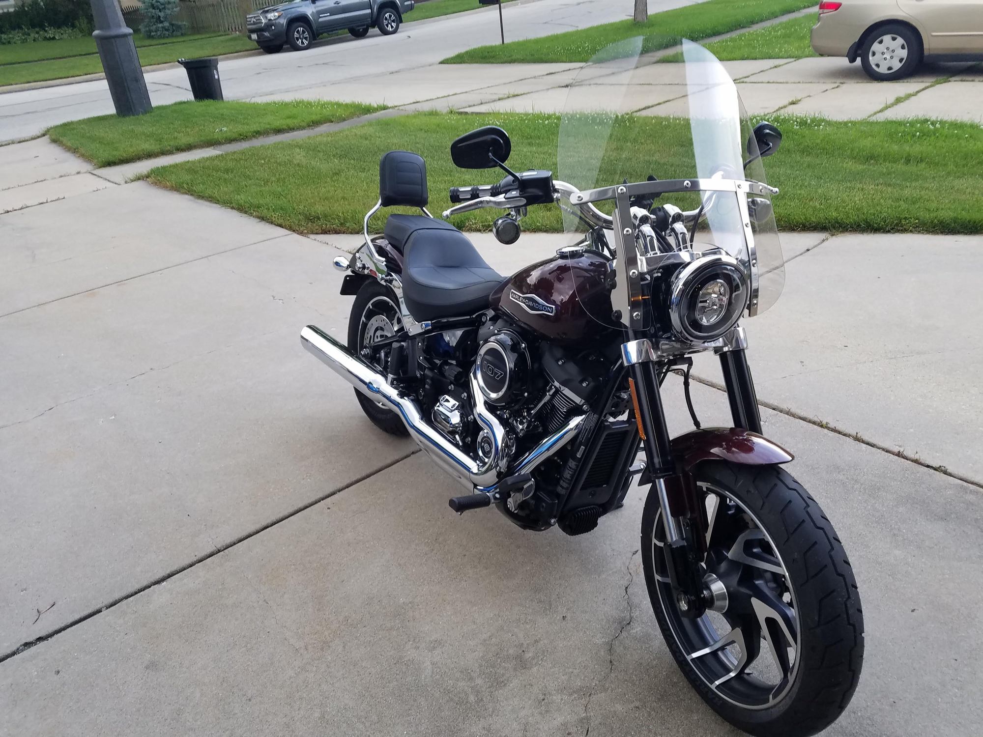

Sport Glide with 19" Memphis Fats
Before I installed the Memphis Shades fairing I had the Fats Windshield. Wasn't too fond of the look but did a decent job and like the fairing I could put it on and take it off easily. Keep in mind with the Memphis Shades windshields and fairing you cannot re-install your original Harley fairing without removing all of the Memphis Shades attachment hardware first.

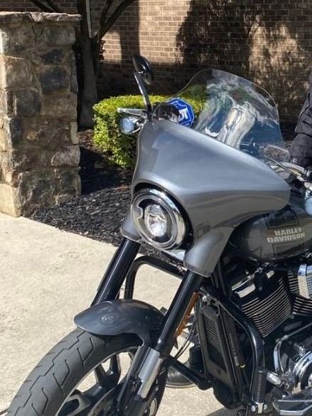

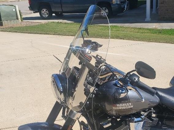

The memphis shade works better but I actually took it off because i like the look of the bike with the fairing on it. New windshield is not as effective as the memphis shade but i like the look.

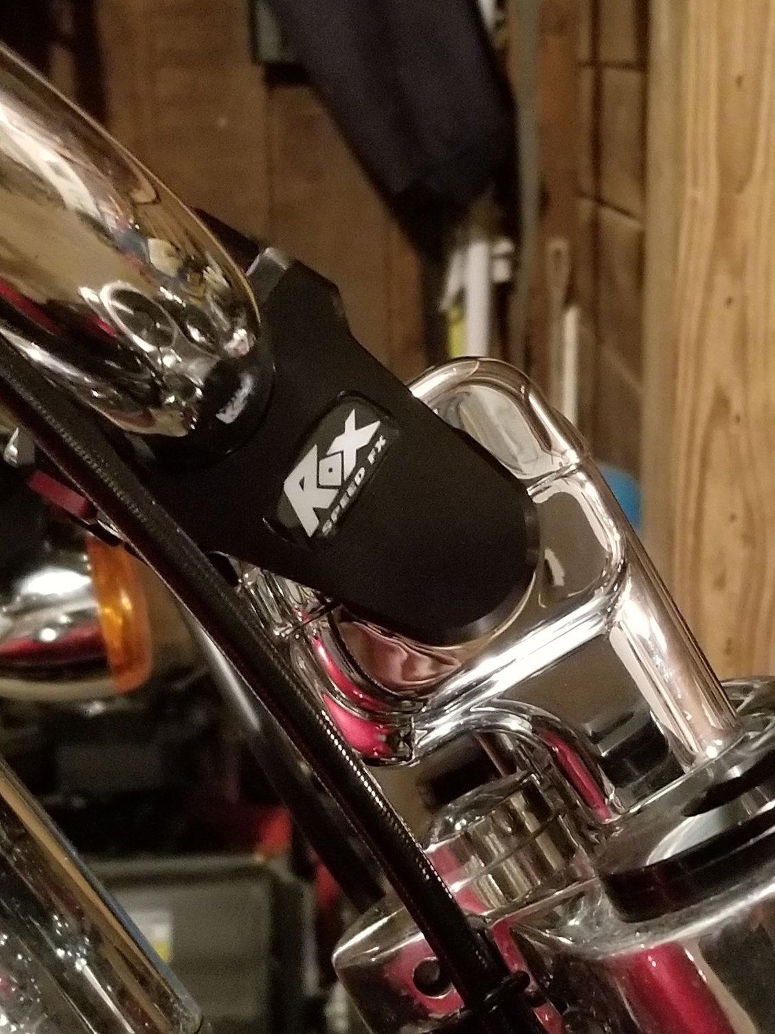

Does anyone have a picture of their ROX 2" pullback riser set-up on a Sport Glide, that they could post ?

Notice I had to get some stubby risers to use with the Rox risers. The angled sides of the stock Sport Glide riser doesn't work with the Rox riser.
I believe the Rox part is:
https://roxspeedfx.com/collections/h...32905171140671
