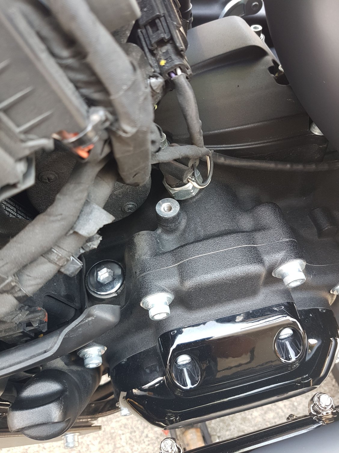

Checking trans oil and saw this after i took the side cover off.
Stock exhaust bracket mount?
Any thought....
2019 heritage classic.

Grounding stud.

Well it is not doing a good job...lol
Is it used for something on a different model?
Seems like maybe not the best plan to leave it open.

Depending on where you live it likely will become a mud damper nest. Perhaps a decorative bolt or plastic button type cap to cover the hole. Yes every hole doesn't get filled however if you first noticed it after some disassembly/reassembly work, check your work bench for some "extra bolts".

I was doing my second service on the bike.
No extra bolts i took off. Harley did the first service and put the exhaust on. The hole is pretty clean for 5000 miles. I will stick a bolt in it. Not really worried that anything fell off just curious.

Per the schematic, a grounding stud (item 13) and nut (item 5) are supposed to be installed here. Not your bike, as they don't have the 2019 Heritage Classic, but from the same frame/engine:
http://partsfinder.onlinemicrofiche....=55&c=0&d=2019

Ok. Grounding stud it is......
Makes me wanna go look for the wire that should be there.....lol
